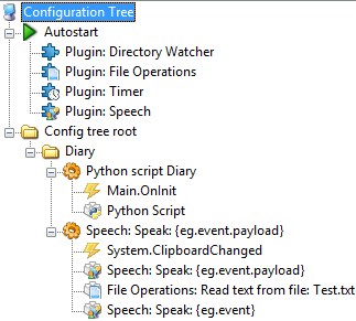

I just do not understand.
I sent you an example of a working configuration.
Why am I doing this when you redo it completely differently?
This is an example functional configuration:And this is your configuration:Do you see the difference?

Hello Pako
Good evening, my apologies to you, I am now using your fixed version of the xml file, what i can now hear is the sound saying NONE.
This is my system setup
Platform is Windows 10.pro.
date format is dd/MM/yyyy
Time format is HH:MM
First day of week is Monday
Thank you for your help

Re: Reading Text from a text file
In the current version, format of time can be completely arbitrary.
Time is not parsed.
It reads the entire file, valid for the current day.
The file is read each time, when you start EventGhost (it makes the event Main.OnInit).
It was your request.
If you want the file read again, you must run the macro "Python script Diary" ( never the macro "Speech: Speak: {eg.event.payload}" !!!).
If it does not work for you, unfortunately I can not see what you're doing wrong.
