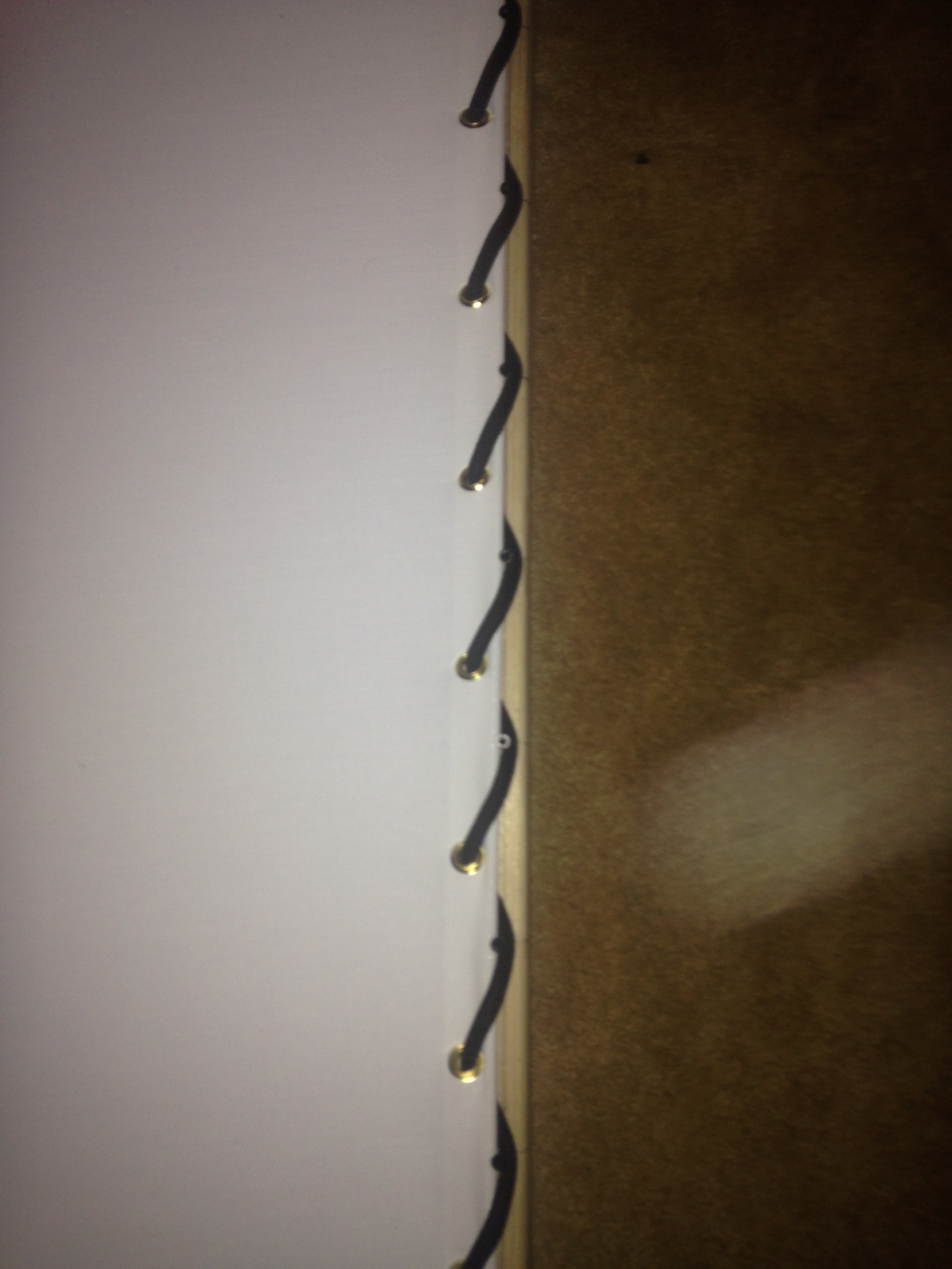

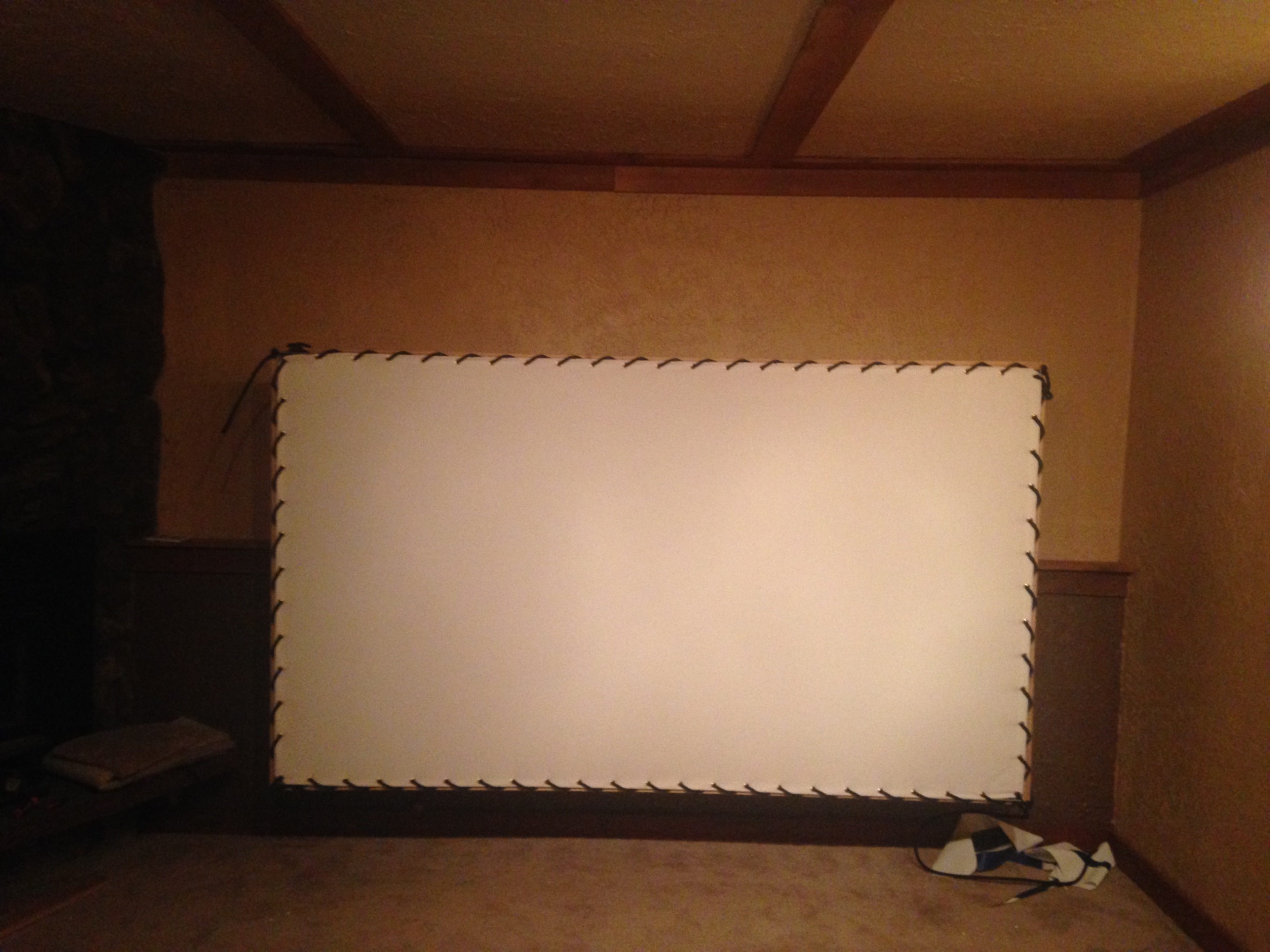

i managed to get the frame build for the screen, and get the screen all grommeted with the fabric wrapped around steel bars that do all the way around the screen.
the grommets went through 2 layers of screen material and are holding the bar tight.
i also tipped the screen material as not to get moire, (was a pain to make sure i could get the most angle with the smallest amount of fabric)
i laces it to the frame with 3/8" shock cord all the way around grommets were every 4"
this thing when i tightened it pulled the fabric so tight i could bounce a quarter off of it easily. i cut the screen for a viewable 100" and now i have a viewable 103"
LOL
border is only going to be around an inch to an inch and a half wide

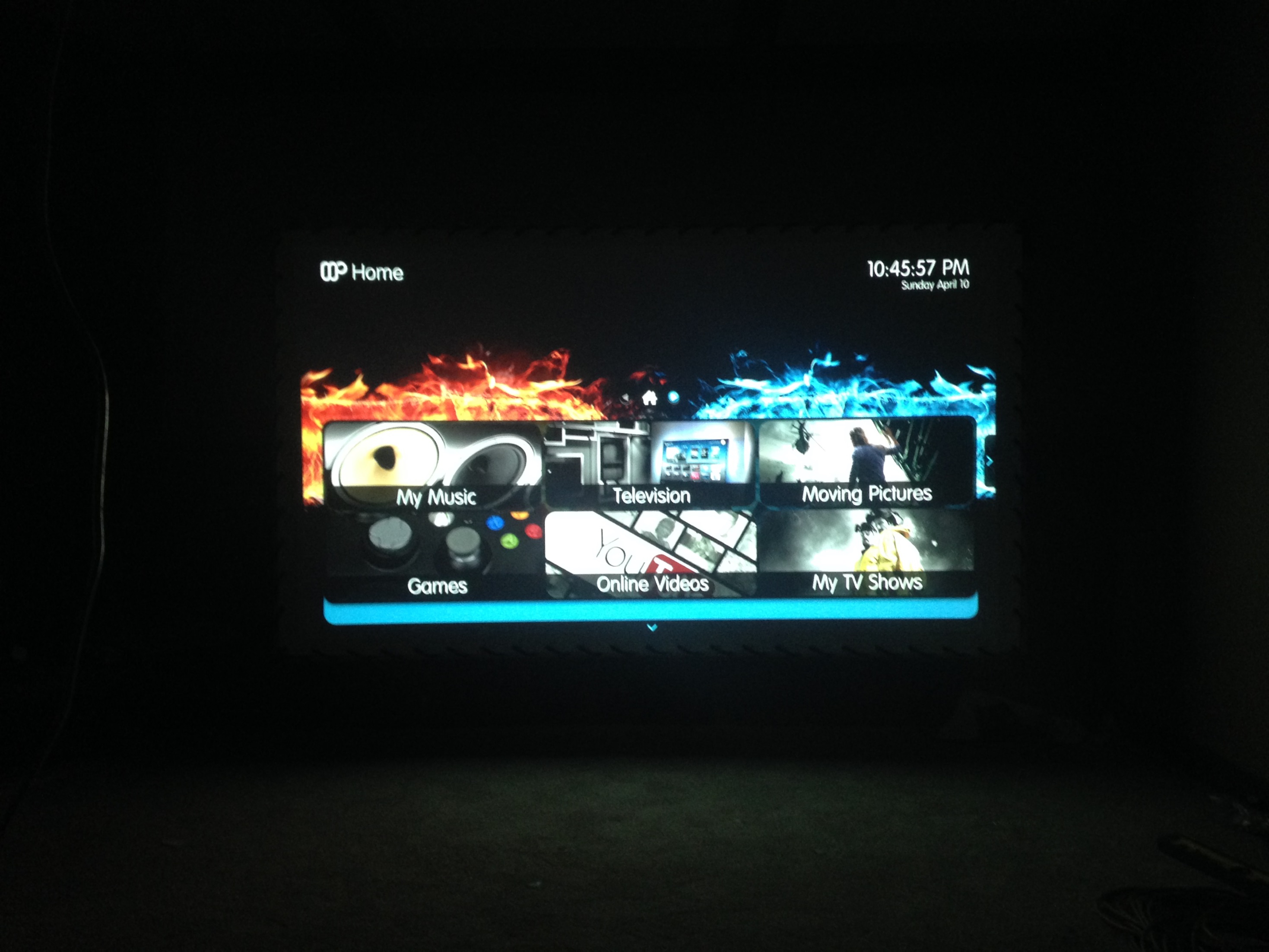

i tried the projector out. it's AMAZING!!!
