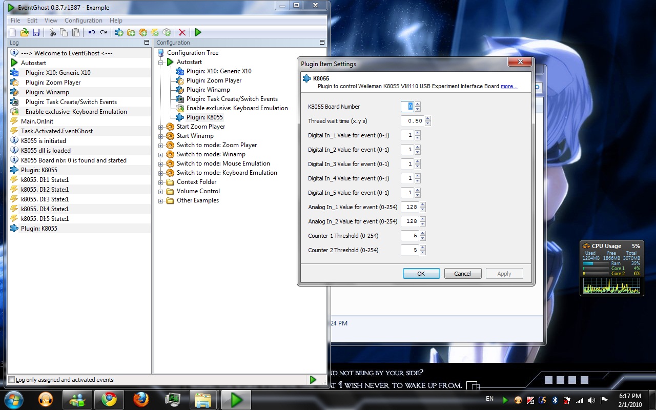

I can't seem to find the option to control output. I think i must have done something wrong. Please correct me if you guys notice any mistakes.
First i downloaded the event ghost program from here
http://www.eventghost.org/downloads/
Then i download "k8055_31.01.2010.zip" from this forum and unzip it to
C:\Program Files\EventGhost\plugins
Then i start the eventghost program by clicking the shortcut icon in my desktop.
I click on the "add plugin..." button (which is right of the "redo" button)
and select k8055 from the "external equipment" folder
As you can see from the screen shot, there is only input options, i can't find the output option.
Another thing that puzzles me is that the LOG says that
"k8055 Board nbr:0 is found and started"
How is this possible? the board was not even connected at that moment.
Sorry if my questions are lame. I really a novice. I am really hoping this event ghost can help me with my project i'm working on with k8055.

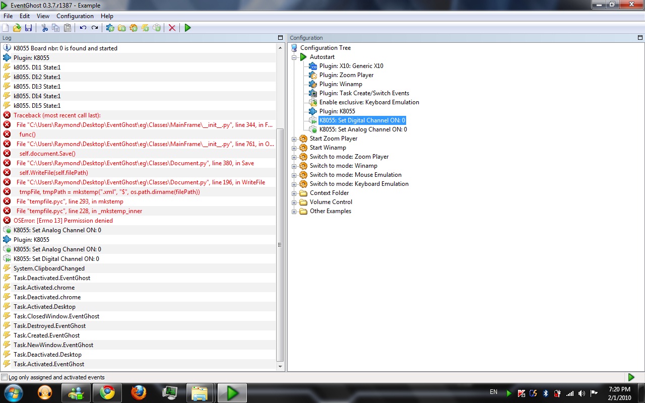

hi guys, i found the way to control the output (i think)
But it doesn't seem to work, the board is connected to the computer,
but when i execute the actions, nothing happens.
And there seems to be an error everytime i save the program.
I can't save it, and i have to add the k8055 plugin everytime i start EG.
have a look at the screenshot for the LOG, it shows the error when i want to save,
and it states the output is on but the board LED remains off
please help me...
please help me...
