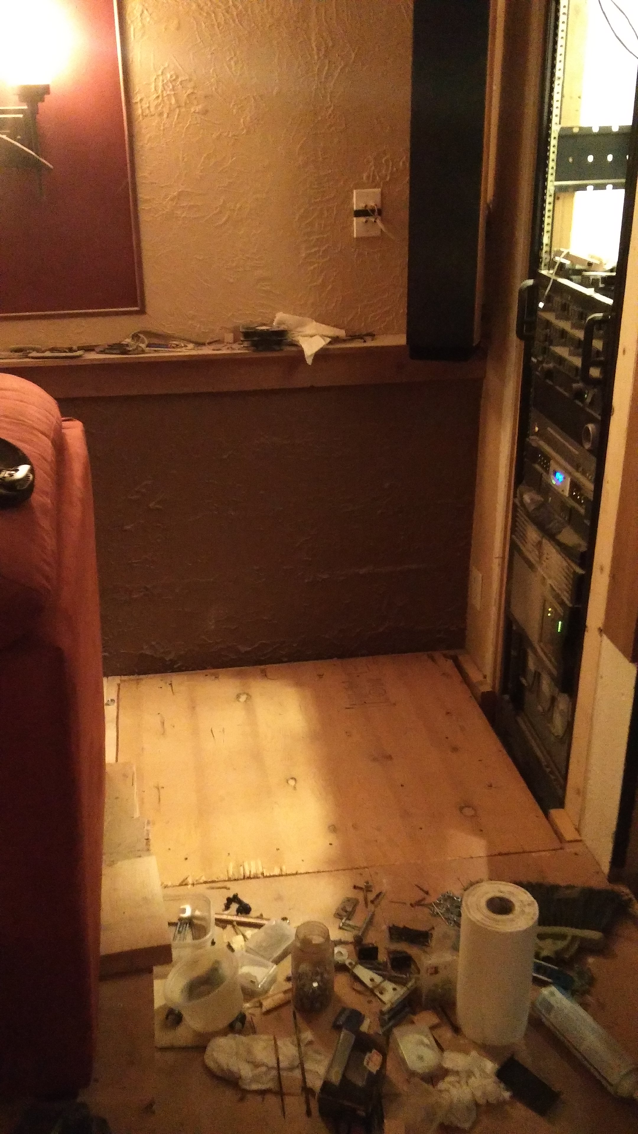

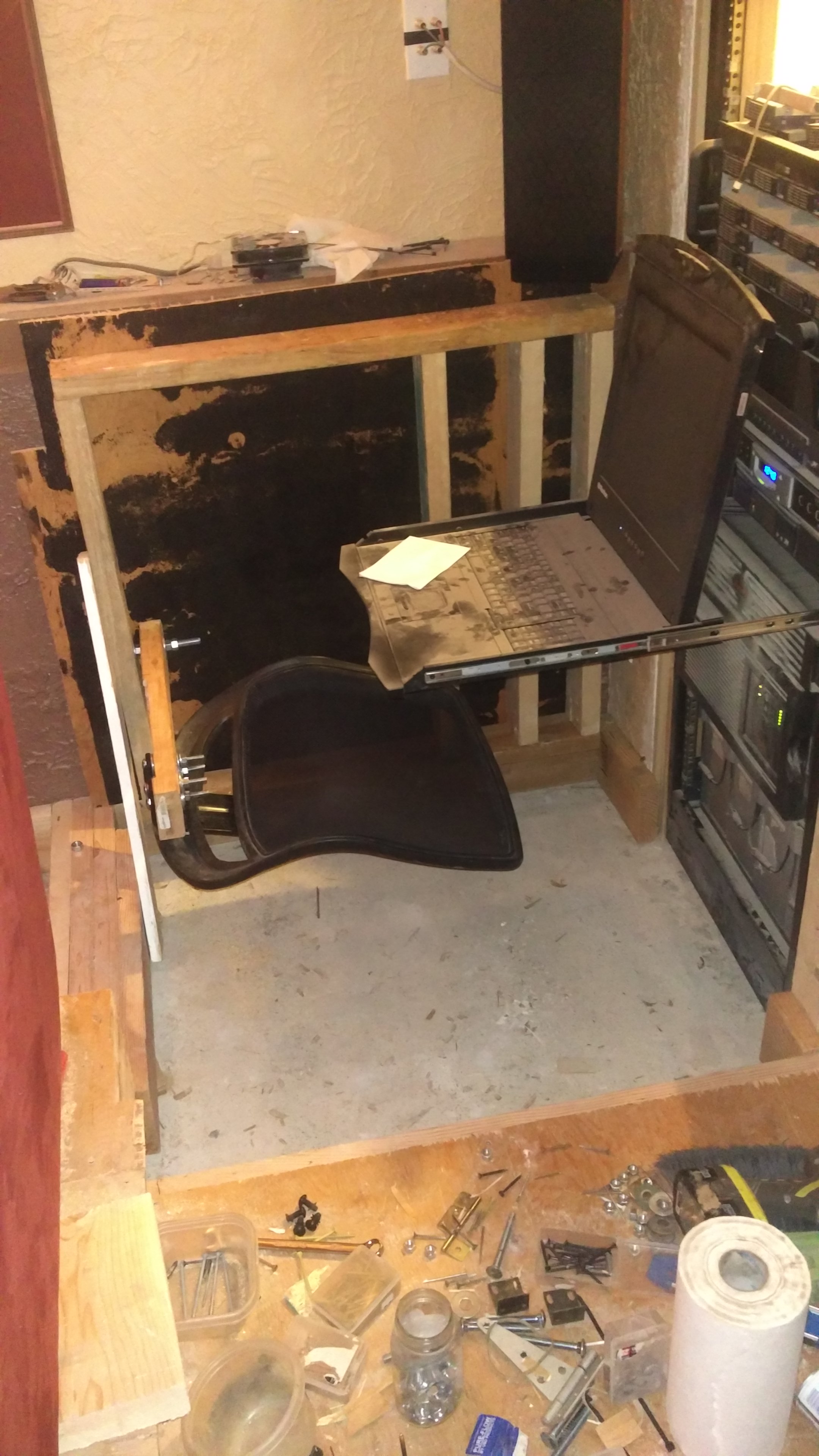

Well I have been working on my media room i ripped up the carpets, moved a wall. raised the back row of seats up 14.5". I built an enclosure to house some subs right under that second row down firing with the opening facing the back of the seats of the first row. 2 12" subs and 2 10" subs. tuning freq is going to be a bandpass on the 10's i want to capture that 80-140 ish area that most systems lack. But because I had to raise a pretty good size section of my media room and that raised section went in front of my rack. I had to make a removable piece just in case i needed to wheel the thing out of the wall. and then i thought hmmm.... i wonder...
mind you this is not yet complete and is a first draft proof of concept.
