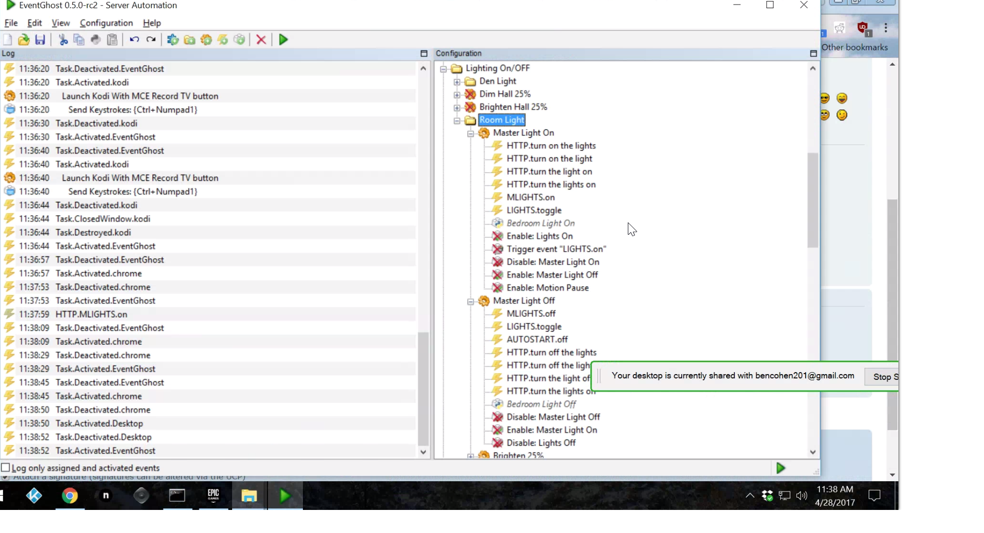

I guess the question is now how do i pass data to this script? This is awesome, was the error from me playing around with this script before eventghost?
I attached the pluggin that use to work for the previous eventghost. I think i got this plugin when i was messing around with x10 devices and the motion sensor. When i use the webserver i can have this plugin find this HTTP.MLIGHTS.off and produce the same command but EG can see what it produces.
I have this event HTTP.MLIGHTS.on and this Macro that isn't firing.
Thank you so much for taking the time to help me out. This is really awesome of you. I hope to be able to do what you do someday. Where did you learn this?
