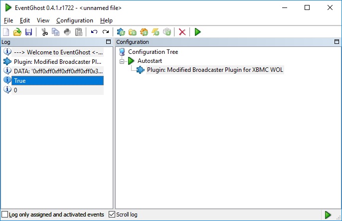

The output I got was
And the code was
DATA: '0xff0xff0xff0xff0xff0xff0x340xe60xad0xe0x430x130x340xe60xad0xe0x430x130x340xe60xad0xe0x430x130x340xe60xad0xe0x430x130x340xe60xad0xe0x430x130x340xe60xad0xe0x430x130x340xe60xad0xe0x430x130x340xe60xad0xe0x430x130x340xe60xad0xe0x430x130x340xe60xad0xe0x430x130x340xe60xad0xe0x430x130x340xe60xad0xe0x430x130x340xe60xad0xe0x430x130x340xe60xad0xe0x430x130x340xe60xad0xe0x430x130x340xe60xad0xe0x430x13'
Re: Help With Broadcaster
Ok cool. As soon as I get home I will parse out the hex
sorry about that i fat fingered one of the hex segments. this one should be fixed

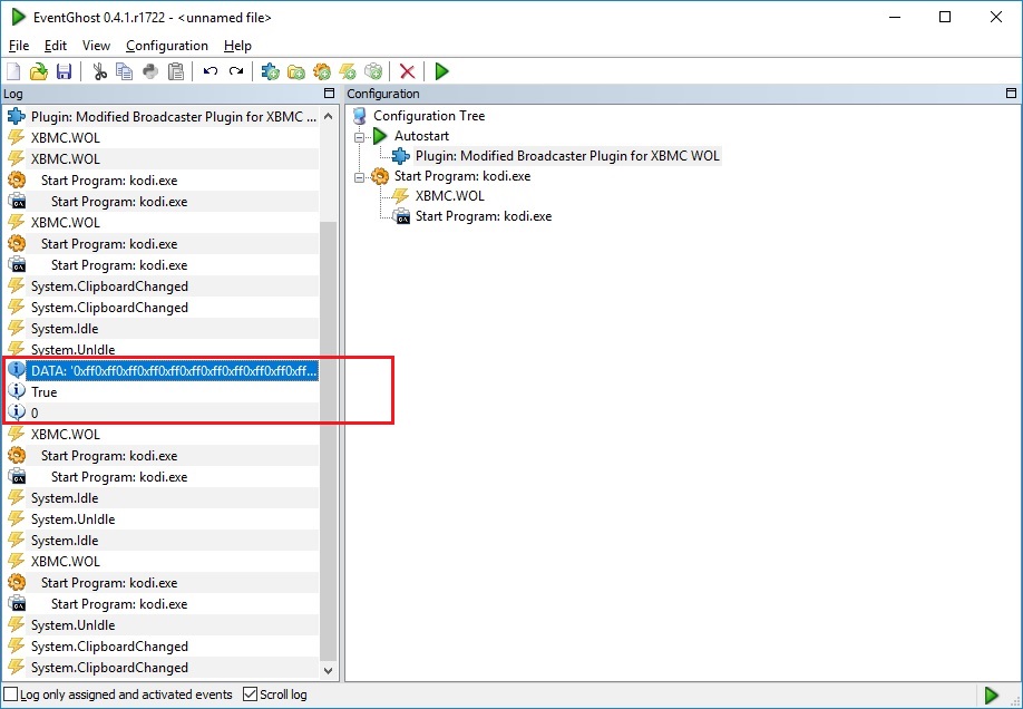

Ok, I ran the new plugin, and it gave out a positive trigger event. I was able to get the following result:
I ran it for 5 mins, by terminating and triggering the event using the WoL from the iOS phone, and it worked fine. But it randomly threw the data that I marked. But other than that, everything was fine.
Here's that data:
DATA: '0xff0xff0xff0xff0xff0xff0xff0xff0xff0xff0xff0xff0xff0xff0xff0xff0xff0xff0xff0xff0xff0xff0xff0xff0xff0xff0xff0xff0xff0xff0xff0xff0xff0xff0xff0xff0xff0xff0xff0xff0xff0xff0xff0xff0xff0xff0xff0xff0xff0xff0xff0xff0xff0xff0xff0xff0xff0xff0xff0xff0xff0xff0xff0xff0xff0xff0xff0xff0xff0xff0xff0xff0xff0xff0xff0xff0xff0xff0xff0xff0xff0xff0xff0xff0xff0xff0xff0xff0xff0xff0xff0xff0xff0xff0xff0xff0xff0xff0xff0xff0xff0xff'

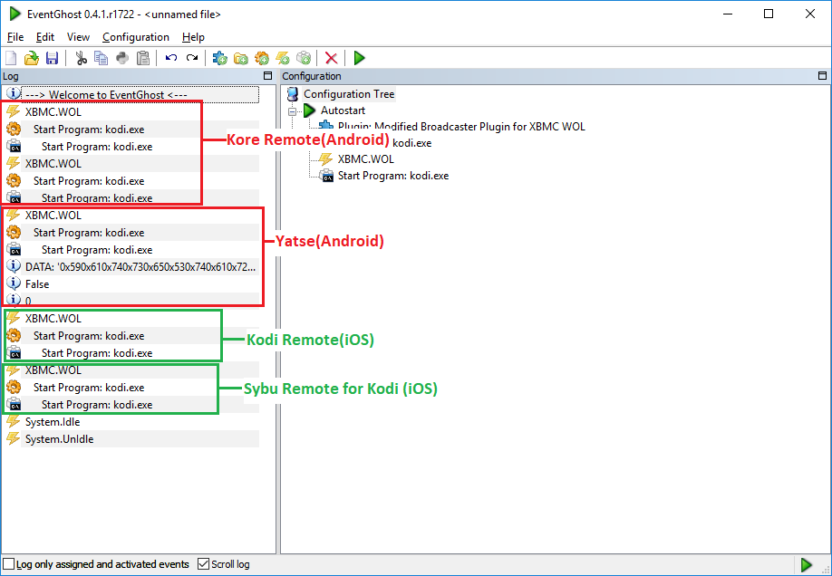

Then, I decided to use an Android phone to further test, and I got the following result:
Kore remote threw out a double WoL command(dunno why).
Yatse Remote was the only app that immediately gave the data info, but it did the task. Here is the data:
DATA: '0x590x610x740x730x650x530x740x610x720x740x2d0x580x620x6d0x63'
the double event can be filtered.
as far as it printing out the data it can be removed it is for testing purposes so we know if any additional data is being sent it could be picking up garbage as well. also I do not know if there is an indicator on the apps that tell you that kodi is running or not. I do not know what the return values would be if that is the case
ok i remove the printing out of the data. I also added the smoothing for the double event. it has a 1 second timer on it so for 1 second after the first wol packet comes in it ill not do anything is a second one comes in.

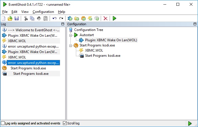

Installed the plugin and got the following output with error code:
And here is the error code:
error: uncaptured python exception, closing channel <eg.UserPluginModule.XBMCWOL.Server connected 192.168.0.163:9 at 0x5095b20> (<class 'wx._core.PyAssertionError'>:C++ assertion "wxThread::IsMain()" failed at ..\..\src\common\timercmn.cpp(66) in wxTimerBase::Start(): timer can only be started from the main thread [asyncore.pyc|read|76] [asyncore.pyc|handle_read_event|414] [C:\ProgramData\EventGhost\plugins\XBMCWOL\__init__.py|handle_read|79] [wx\_core.pyc|__init__|14705] [wx\_core.pyc|Start|14722] [wx\_misc.pyc|Start|1315])
OK hopefully this one will do the trick.

I installed the new plugin and everything ran fine. No errors and no extra data info. The Kore Remote(Android) was still able to get in the double WoL packets, but every other remote seemed to work fine.
