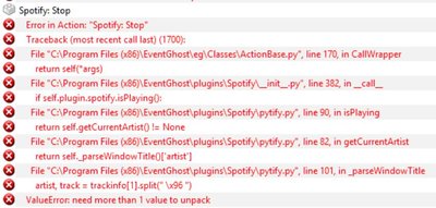

I have the latest version of Spotify, Eventghost and your plugin. The play button works, but then as soon as something is playing it stops along with the Stop and Play/Pause.
I get the error in the attachment,. Any ideas?

Spotify changed their window caption formatting and now uses a simple dash instead of \x96, and removed "Spotify - " from the title when playing.
Here is the required modification in pytify.py.
Core feature works as of 2016-11-13
def _parseWindowTitle(self): # mkedit
trackinfo = win32gui.GetWindowText(self._hwnd)
if trackinfo == "Spotify" or trackinfo.find(" - ") == -1:
return {'artist': None, 'track': None}
artist, track = trackinfo.split(" - ")
return {'artist': artist, 'track': track}
