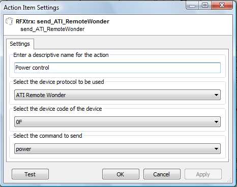

now also supporting sending remote key pressures
I don't understand this
Yes, maybe not so good explained and maybe also not so useful. The thing is that the PC computer now can act as a remote, it can send remote keys via the RFXtrx. If this is useful, I do not know but it is anyway supported by the RFXtrx so I implemented it.
To use it, you can simply create macros like this:

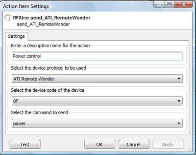

I install ati remote wonder software on my computer and assign one touch :
Then I put an event in eventghost and it work fine :
I open Notepad with the ati remote wonder with the rfxcom and ati remote dongle if it was you want to know.
