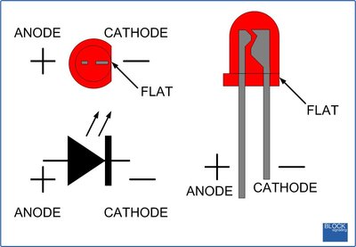

well that's close. but with blasters they don't use a stereo headphone plug. so what you are going to do is you will wire to the white and the shielding.. the anode (the longer wire on the LED) goes to the white. and the cathode goes to the shielding.
and you will only need one LED it's a waste to use 2 because you are not going to overdrive the LED (amplify the signal) and also because you are going to stick that LED right onto the eye of whatever it is you are going to control. now... in the case of wanting to control multiple items you can either split that thing into a bunch of LEDs (looks like doo doo) or you can go and buy one of these bad larries https://www.sparkfun.com/products/retired/10732 this will allow you to transmit IR up to 35 feet (no BS) and just point the thing in the general direction of your gear.doing this is going to require a couple of parts one being a USB cable the second an old USB cell phone charger. this is what you would use to power the thing.. the power and ground from the USB go to the power and ground on the amplified IR piece. and the headphone white goes to the S or signal line and the shielding will also go to the ground just like the ground on the USB

kgschlosser wrote:well that's close. but with blasters they don't use a stereo headphone plug. so what you are going to do is you will wire to the white and the shielding.. the anode (the longer wire on the LED) goes to the white. and the cathode goes to the shielding.
Excellent explanation! Thanks a million for the explanation. I'm gonna give it a swing because I think I have an IR LED around here somewhere and because you even posted a picture for me! Fingers crossed that I won't burn the house down! :lol:
