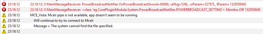

I'm having a problem with the service just randoml, (seemingly), dropping out. Here's my log at the same time as the error message, but it doesn't seem to show much.

I found this in the Win 10 Event Log:
Faulting application name: AlternateMceIrService.exe, version: 0.0.0.0, time stamp: 0x4eda3c4c
Faulting module name: ntdll.dll, version: 10.0.15063.447, time stamp: 0xa329d3a8
Exception code: 0xc0000374
Fault offset: 0x00000000000f775f
Faulting process ID: 0xdd4
Faulting application start time: 0x01d30ceae7a1edeb
Faulting application path: C:\Program Files (x86)\EventGhost\plugins\MceRemote_Vista\AlternateMceIrService.exe
Faulting module path: C:\WINDOWS\SYSTEM32\ntdll.dll
Report ID: 4a75e7f1-f43b-4952-acde-d0523afa39db
Faulting package full name:

Hope that helps track it down a bit!
