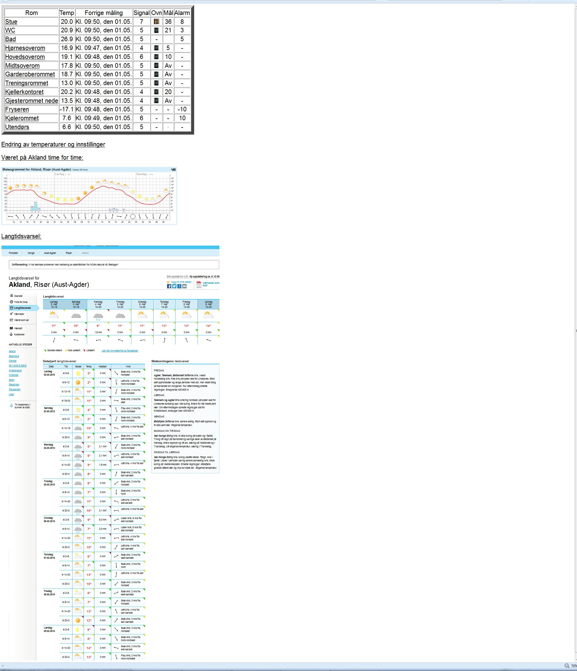

Would it be possible to put a number of links on each of those pages (in the same way a you personalized those headings)? I was thinking of the possibility of perhaps having 4-5 links at the bottom to go to temperature overview and other graphs, for instance. Or would that maybe be better done by putting the graphs as a frames in anoter website? I have something like that with the weather on my house website, where I have the long term weather in a frame hiding the headings and a few other things, all run by the EG Webserver plug-in:
