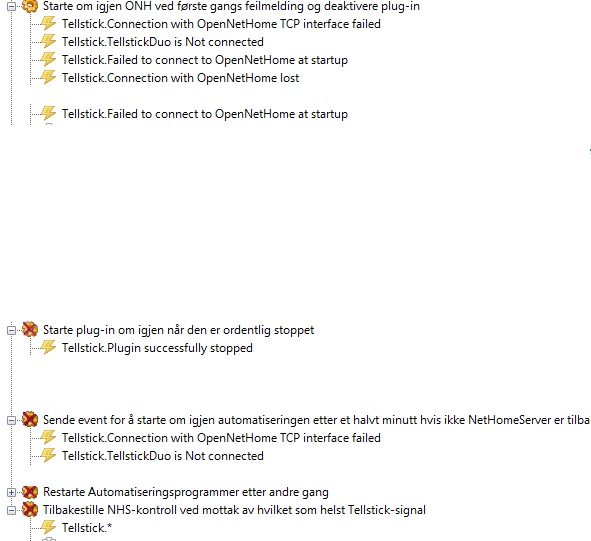

But now I have done the changeover, and I'm glad the only difference in the python code on commands were ONH instead of NetHomeServer. That made it easy to do a search and replace in Notepad++ to correct the Python scripts! So thanks for that! I have checked that the commands work as well (I'm two hours away, but I can see in the RFX logging that it sends Off to the oven I'm testing with). But what about the warning actions? I saw the one for a fully stopped plug-in was changed to the name of the instance (Tellstick). And I see this:
OpenNetHome.Failed to connect to NetHomeServer at startup
turned into
Tellstick.Failed to connect to OpenNetHome at startup
Does that mean that OpenNetHome as the start of all warnings should be changed to Tellstick, while NetHomeServer should be changed to OpenNetHome? I have done that, and I'll see if it works. :) Interesting, this is the biggest change I have done to the system since I sold the house!

This is how it looks in my system, did you configure the event prefix in the plugin setting (I have ONH as prefix)?
13:46:44 reconnect to host
13:46:44 Failed to connect to OpenNetHome at startup
13:46:44 ONH.Failed to connect to OpenNetHome at startup
Ok, now you have done the editing, but you could have defined the event prefix as 'NetHomeServer'

I have been using Tellstick as my prefix up to now, and I have around 10 very long scripts that refers to it, so that would be a lot more editing. :) So with Tellstick as the prefix I should be OK with this?
Re: OpenNetHomeServer
correct, but all events related to the plugin will have that prefix (leaving the field empty -> the prefix = ONH)
