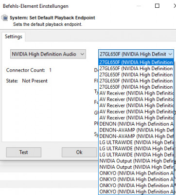

Dear kgschlosser,
i want to use the Core Audio Plugin to switch my default playback and communication device in windows 10.
It works to switch to my HDMI-device on my internal graphics card, but it fails to switch to my HDMI-device on my NVIDIA graphics card.
After plugging in/out, reinstalling drives, cleaning old devices in the device manager, reinstalling the plugin (by deleting the plugin files in %programdata%) i still cant figure out what the heck is going on..
My first problem is, that i have a lot of old devices to choose from, which don't exist in my devices manager anymore, when i go for example to "set default playback endpoint". See Screenshots for my device list and my device manager in windows.
Is this still an old list from before my cleanup?
If yes, where is it stored and how can i truly delete/re initiate the config for this/any eventghost plugin?
If no, where the heck are these devices in windows still registered, can you give me any hint?

Alright, after some more digging i found my old devices in my registry. Here i can clean out Old devices, after deleting old versions of my device and renaming my device i could finally switch to my HDMI-Output from the NVIDIA Card.
The Devices are stored under:
HKEY_LOCAL_MACHINE\SOFTWARE\Microsoft\Windows\CurrentVersion\MMDevices\Audio\Render

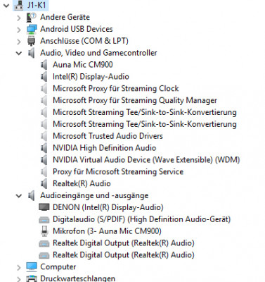

The list you are seeing in the first attached image are not "devices" they are endpoints. the devices list is the drop down to the left of the one you have showing. A device can have MANY endpoints. some of those endpoints may be internal to the device.. like loopback endpoints. Or they may be for endpoints that connect to another device like a CD ROM drive.
When you open the Windows Sound Control Panel you are going to see a list of endpoints. Those endpoints are from all devices. That list is a list of only the endpoints for devices that are currently present in the system. because of the wonderful world of USB a device may not always exist in the system.. Take a webcam for instance, These commonly have a microphone and will show up as it's own audio device. The user should be able to set up macros whether the device is attached or not. so long as a driver is installed for it you will be able to choose it in the plugin.
If there are old device drivers still installed that you do not use any more these can easily be removed by doing the following.
Open up device manager. click on the "View" drop down menu at the top and check off the "Show Hidden Device" option in the menu. This is going to populate device manager will ALL device drivers that are installed whether or not the device is actually attached to the computer. You will be able to remove device that no longer exist in your system this way..
NOTE: check your USB devices as well as you are going to see mountains of drivers installed. There are loads of USB devices that also are considered sound devices. Cell Phones, Tablets, Camcorders and Webcams just to name a few. That means if a friend plugs a cell phone into your computer to only charge it, drivers are going to get installed. they do not get uninstalled when the device gets unplugged. The really nasty part of this is it will install a driver for each USB port a device has been plugged into on your computer. so if you have a webcam and you computer has 6 USB ports and the camera has been plugged into each of those ports at some point in time there are going to be 6 drivers installed.
Some education on what an "endpoint" is
The organization of "endpoints" can be confusing. an endpoint would be the end of the line. that end of the line can either be a renderer or a capture. capture being input and renderer being output. a physical jack is not an endpoint. an endpoint can be multiple jacks (surround sound). the plugin is going to show you all possible endpoints that are available for your sound device. This is not going to be the same list that you see in the Sound control panel for Windows.
the best thing to do is to play some audio out of that endpoint or change the volume on that endpoint. You will see an event take place in EventGhost. The event is going to contain the device name and also the endpoint name you will need to locate in the action control panel.
here is an example event
CoreAudio.High Definition Audio Device.Headphones.Volume.5.0000
and this is the bits you need.
the device is
"High Definition Audio Device"
the endpoint is
"Headphones"
When changing the default endpoint the endpoint you are changing to MUST be plugged in. The error that happens when the endpoint gets set to the default and it is not plugged in is not handled gracefully, this is something I will fix.

Alright. I think after digging though my whole system i understood the concept of devices, endpoints, hidden devices/drivers and so on. Your list was just filled with endpoints of devices that where not existent anymore.
Since i found the location in my registry, where these old endpoints where still registered, i could clean up and was finally able to select a existing endpoint. that seems fixed to me and not a problem of the plugin and more of the mess, windows is creating.
In the beginning (why i just started this post), was the problem, that i could not select the right endpoint, because it just wasn't in the list. I tried every old endpoint but nothing switched to my existing endpoint.
