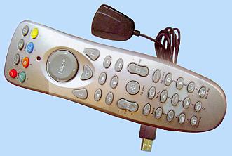

@pouz
If you own this: remote control, follow these steps:
1) Plug receiver of the remote into the USB port
2) Download and run driver http://www.eventghost.org/downloads/USB ... Driver.exe
3) Download DX_USB_Remote.zip, unpack it and put the contents into the folder EventGhost\plugins
4) Run EventGhost and add plugin Deal Extreme USB PC Remote

Re: Plugin for USB PC Remote Controller
Pako wrote:@pouz
This is exactly my remote.
Will this work on Windows 7 x64?
I cant seem to find the link for the dx_usb_remote.zip.
