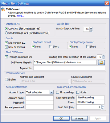

Maybe there is anything i forget in the configuration ? I don't remember this window in the old version...
Re: DVBViewer
No, it can't be a problem of the setup. The missing files is not a plugin problem. They should be generated automatically by the pythoncom library on the first access to the DVBViewer.QuentinSat wrote:I have nothing of that![]()
