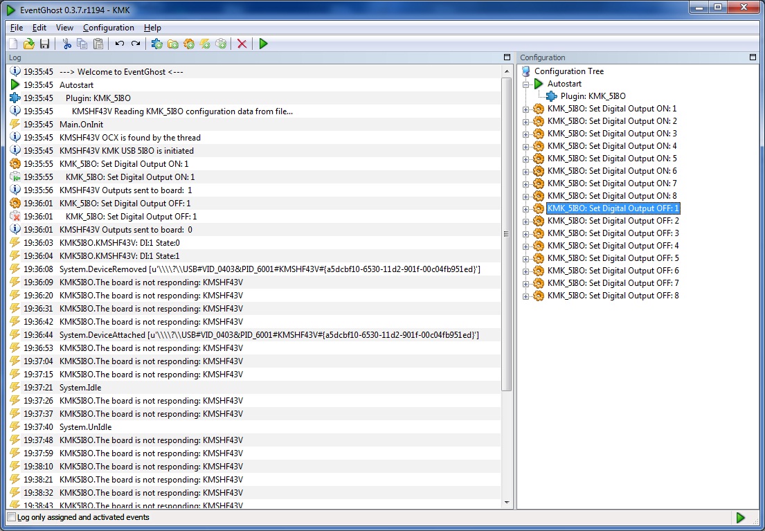

Re: KMK USB 5 Input 8 Output Channels Controller
Jostein,
Attached is a version I believe/hope will work with the board. I have tried to simulate as much as possible
Changes are
- detects when a board is not responding and then responding again (creates events when this happens)
- added additional information to events and printouts to help identify which board they belongs to (in case you would have multiple boards connected)
I found that the best way to check whether the board is responding or not is to read inputs. There is also no need to stop threads because we communicate with the OCX and not the boards directly
If you start with the board connected it should work fine and fast. If you then disconnect the board you will get an event. Connect the board again and when the board is found, you get a new event for that and then everything should be back in normal operation again
Changes are

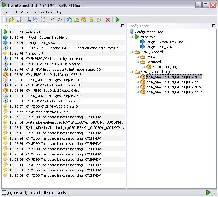

Hi.
Just tested. It does not start up again after disconect and reconect.
I was thinking that you forgot to open the port after close but after what i can se from the code it opens at line 293. The way i understand it when it disconects that tread gets run every 10secund instead of the "thread wait time"?
I tried changing bits and pices but unfortuntly i did not get it to work.
Do you have any more ideas on what the problem could be? -Jostein

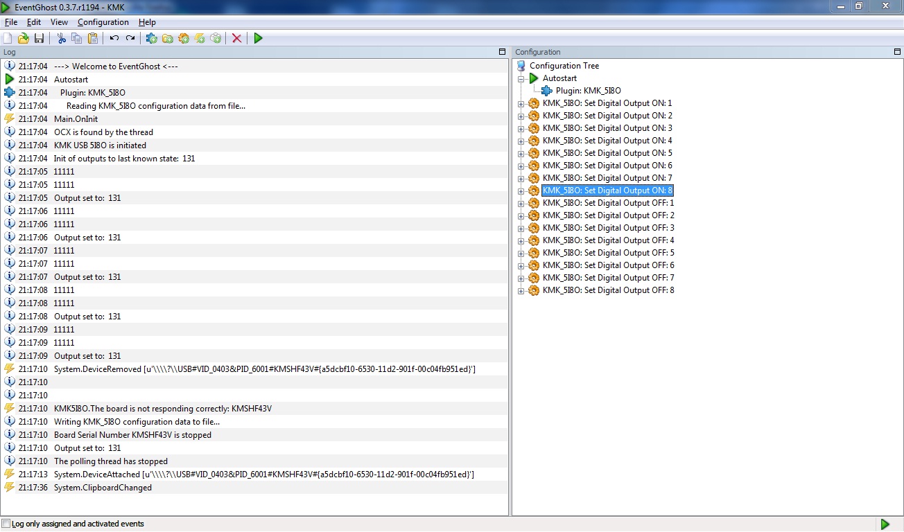

Hello Jostein,
I picked them up from the post today (was also travelling last week). As you said, the quality is really good it seems
It's so much easier to debug and test now
Attached the version that works for me (with two boards connected and running)
If I disconnect/reconnect it recovers the communication, the input triggering and the last known output states
