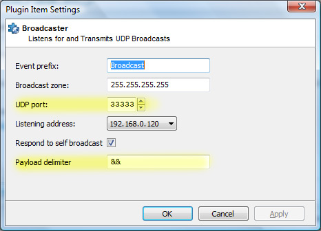

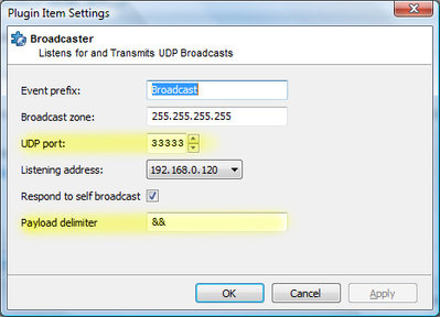

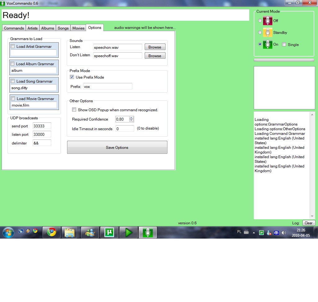

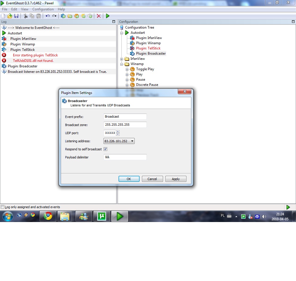

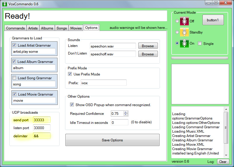

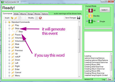

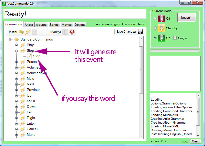

do you have the broadcaster plugin installed and working in eventGhost?
this one:
http://www.eventghost.org/forum/downloa ... hp?id=1304
check the settings for the plugin and the settings in vox to make sure they match. (see attached images)

Yes I cheked it and had som on both EG and Vox.
What i need to do now

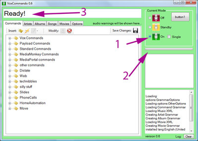

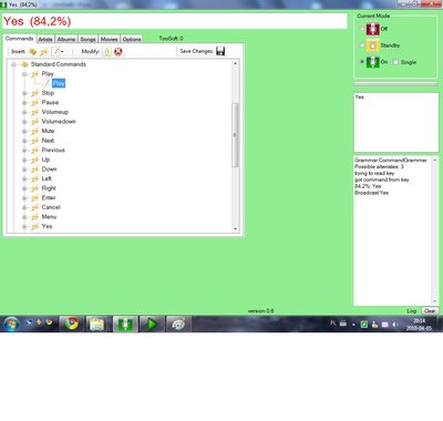

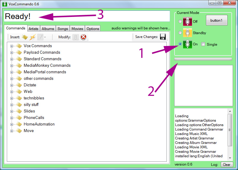

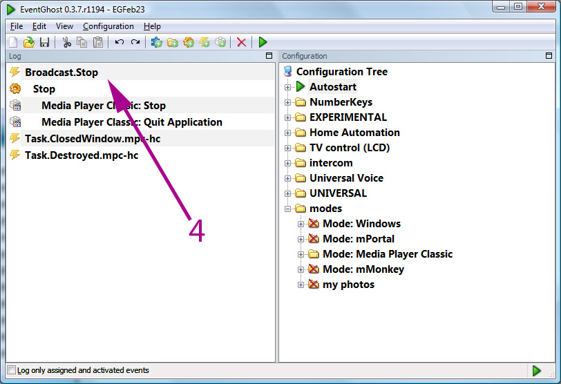

1 - Vox should be in the "On" mode and the background should be green.
2 - If your Microphone is set up correctly and Vox is able to hear you, you should see the green bar on the right move when you talk.
3 - Vox should show some words here based on what it can hear you say.
4 - if you say a command that Vox recognizes it should then generate an event in the eventGhost Log window, the same as if you pressed a button on your remote.
Check these 4 things and let me know. I don't know if you changed the command tree in Vox but the default setup should already have basic commands like:
play, pause, stop, etc. If you think you may have messed up the command tree, you can just replace "voicecommands.xml" with the one from the zip file.

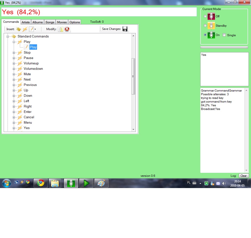

Re: Vox Commando - Voice Commands

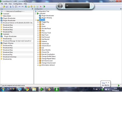

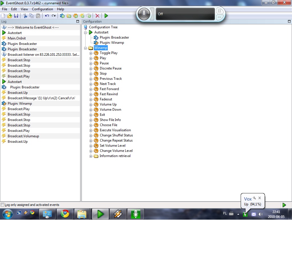

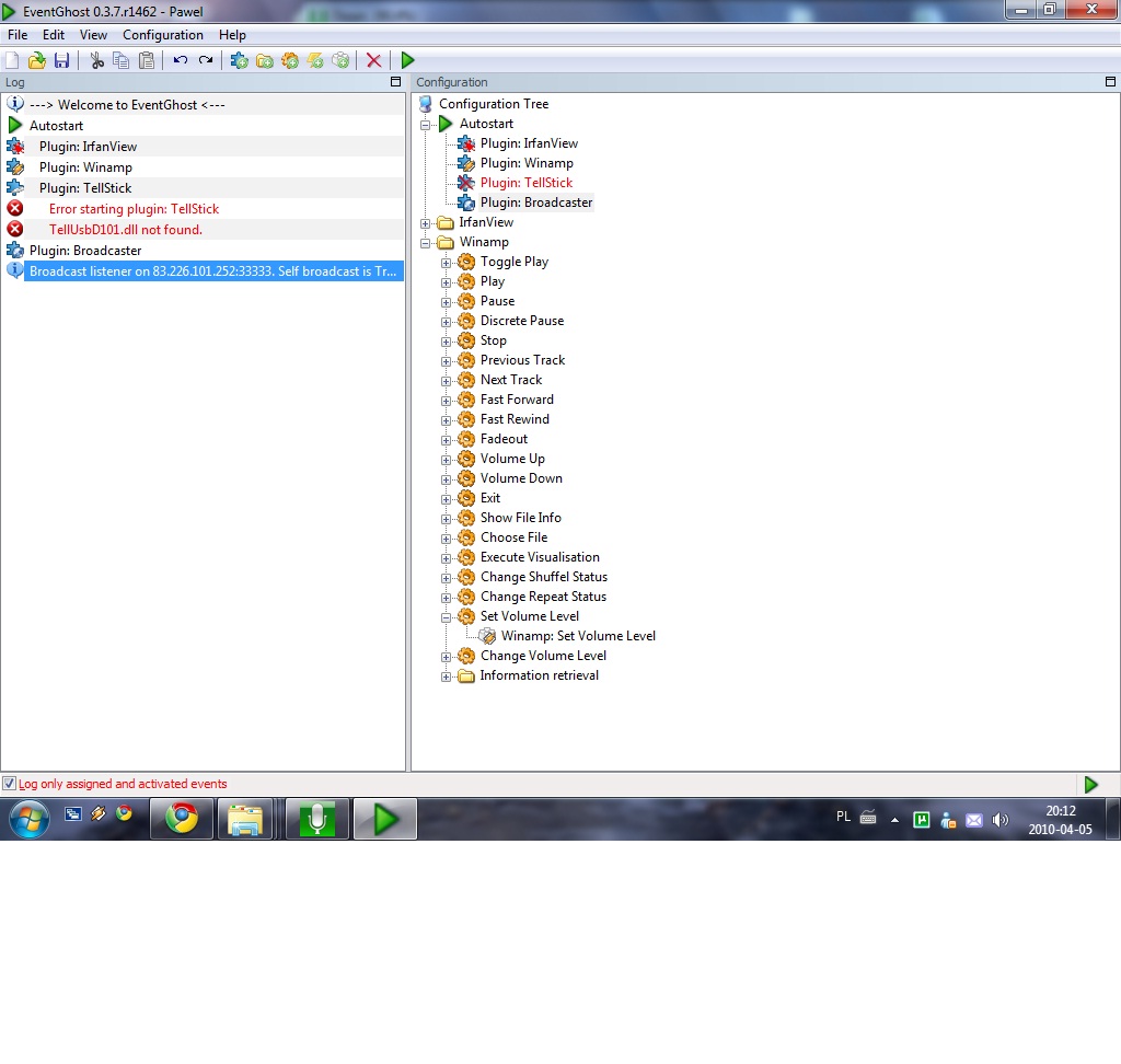

On EG i get just boarcast listening and port (see picture), i dont get comand like you Boardcast.Stop, I cheeked ports and its the same on both application
my mic and vox comand understanding (speeking) works fine

OK good. Vox seems to be processing the command OK. It looks like the problem is somewhere between VoxCommando and the broadcast plugin.
1st check the plugin settings for EG broadcaster.
- make sure that "respond to self broadcast" is checked*.
- check the "listening address" pull down. I think you want the one that starts with 192.168.
See if that works. If not, try disabling your firewall temporarily to see if it is blocking the udp packets from getting through.
I have another listening address. My begins att 83.226.
and i can't change it
I checked respond to self broadcast and it was on.
and yes I use VoxCommando on the same computer as EventGhost

did you also try to disable (temporarily) your firewall to see if that made a difference?
I think it has something to do with your IP address. A local area network address usually starts with 192.168
Yours looks like a Wide area network address, like the address of your modem on the internet. I am guessing that you somehow connect directly to a modem and are not going through any kind of router.
Try sending a broadcast using the broadcaster action in eventghost. Make sure you are sending on the same port that the plugin is set to listen to. See if that shows up in the log.
If that doesn't work then maybe you should try posting on the broadcaster forum and see if someone there has an idea.
