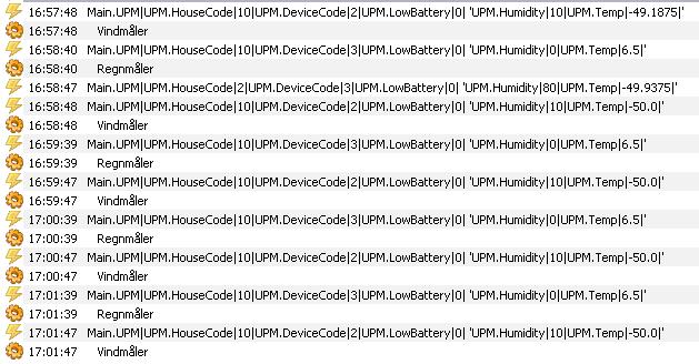

Here you can se the values i get on the "station" and in EG:
In norway aslo the most comon wind speed is m/s.

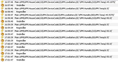

First try i got a error not sure why.
Tried restarting nethome an EG again.
Got it working with the wind sensor.
I see that you have changed the value to m/s as i have 5,56in EG and 12mph, 20km/h on the "station".

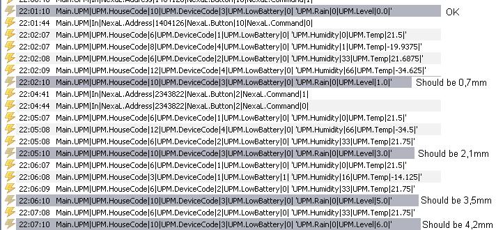

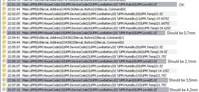

The rain sensor there is a fault:
For every time i tip the bucket the "station" ad 0,7mm in eventghost i get 1.
Exept from that it works perfect.

Should fix the rain level correctly. Changed labels for wind data as well.

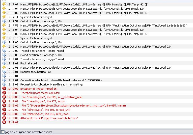

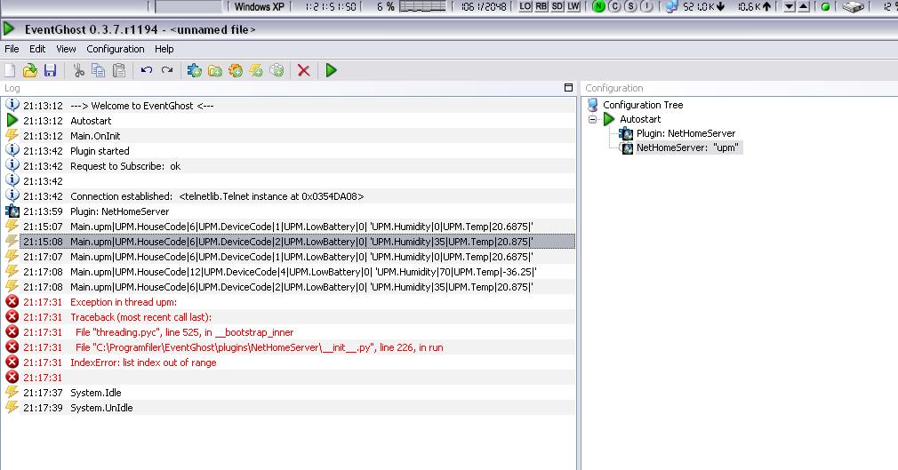

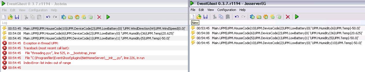

I get a fault when the wind dir sensor is at a certain point. The fault stops the plugin mening that i have to restart it to recieve events again.
To try understanding the fault i tried running the previous version(Before rain and wind suport, From your first post) on one computer and the new one on another. The new version crashes.
I dont understand what the code on line 226 does other than that it has something to do with the wind direction.
It is not always there but only at certan points.

The bug is coming when I try to map the value for wind direction to the correct label. I have made some changes to this part to improve the code and also added a printout if things goes wrong just to be able to trace the problem better (will be removed when finished)

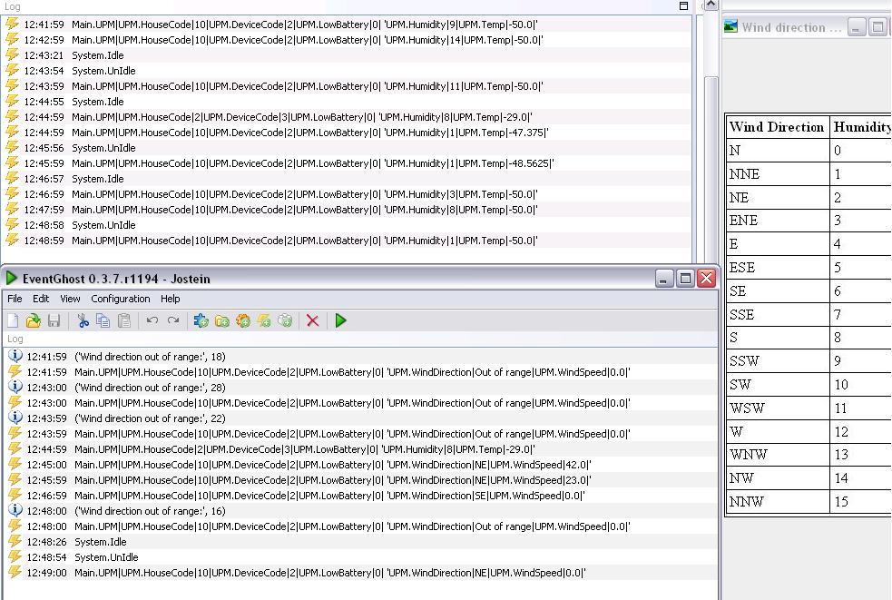

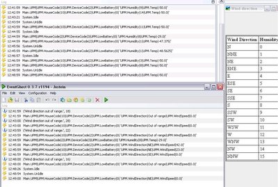

The wind directionStil have some bugs:
Bug that came when switched from m/s to km/h Not to important it worked on aftervards as it should.
Here are two screnshots from the log.

OK, thanks for detailed testing and screen shots.
The bug that comes when changing from m/s to km/h and vice versus is most likely due to that the thread restarts to quickly. I will see if I can delay it further.
I'm worried about all the readings "Out of Range" for the wind direction. I will review this part of the code further, most likely I have made an error in clearing variables or so. I will add more debug info in the printout for those errors

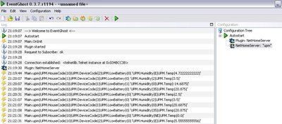

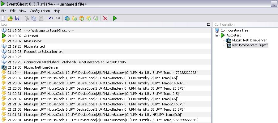

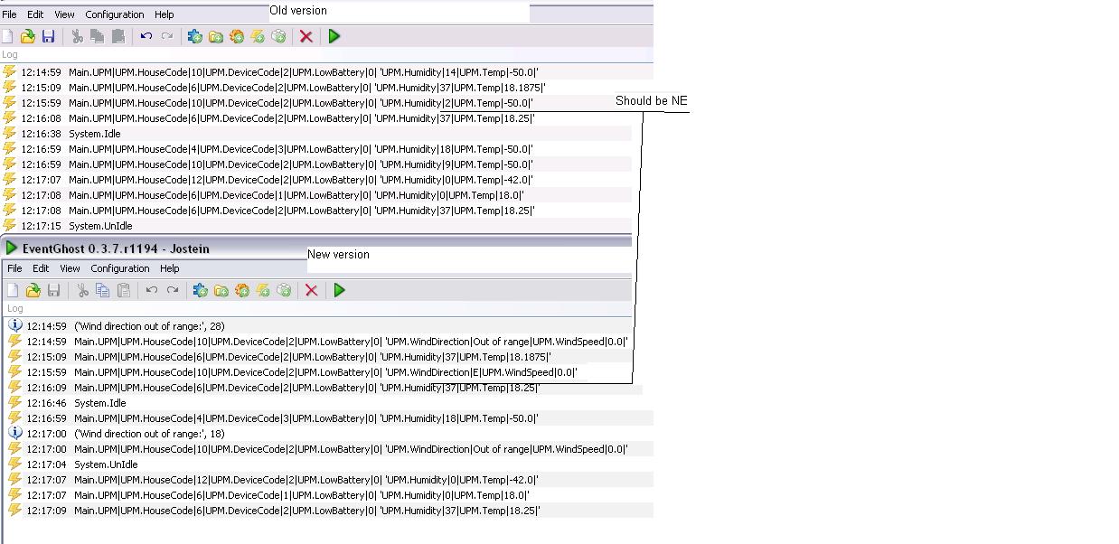

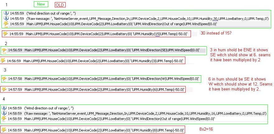

I think i have figured out what the fault is and have tried explaining it in the scr(Red is the Oldest version and green is the new):
It seams that every humidity value is multiplied with 2 in the new version. So that is why it goes to out of range when it leaves 15.
I am not sure why it x2 but i will try to figure it out from the plugin. You might have mutch bether luck doh as you now more where to look.
krambriw wrote:I will try to make a first shot on the rain ackumaulation calculation when we have a stable operation
Loking forward for it maby an avrage wind speed for last 15min or hour also in case of a strong gust at the time it reads the wind.
Best regards Jostein

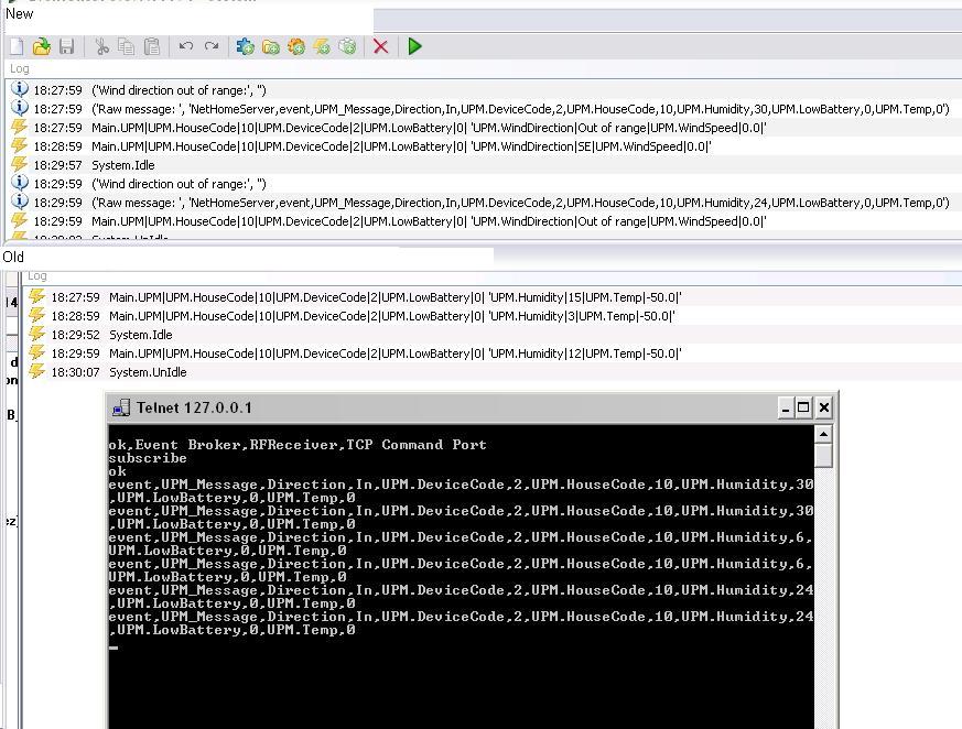

Ooops, the raw message in your screen shots is more or less how it looks like when it comes from NetHomeServer...
In the old version I always divide the humidity value with 2, that is why it looks like if it works. For the wind direction, I cant divide with 2 because the expected value should be 0-15 and that is what it is (most of the time)
Just to verify if it is a bug in NetHomeServer itself, could you start a telnet session and compare how messages look like there. First you need to find Telnet.exe in your computer (Im not sure, but maybe you have to activate it if you are running Vista)
http://www.tekniken.nu/utvecklingstips/telnet_i_vista
You do not have to close EG for this test, let it run in parallel because NetHomeServer supports multiple telnet sessions. From command prompt or double-click to start telnet
From prompt type (if this is the PC where NetHomeServer is running)
o 127.0.0.1 8005
+Enter
Then type
dir
+Enter
and you will see a list of all instances defined in NetHomeServer
Then type
subscribe
+Enter
After a short while messages will be displayed in the telnet window. Try to mark, copy, paste messages with wind directions and compare the values with the ones received and logged in EG
Type
quit
+Enter to quit
If it is like I suspect, there is a bug in NetHomeServer. In that case we need a bugfix but in the mean time I can make a plugin version that divides the value with 2 if it is higher than 15
Jostein
Posts: 108
Post by Jostein »
Hi.
im on winxp.
Am not sure i understand the bug myself hope this will help.
ok,Event Broker,RFReceiver,TCP Command Port
subscribe
ok
event,UPM_Message,Direction,In,UPM.DeviceCode,2,UPM.HouseCode,10,UPM.Humidity,30
,UPM.LowBattery,0,UPM.Temp,0
event,UPM_Message,Direction,In,UPM.DeviceCode,2,UPM.HouseCode,10,UPM.Humidity,6,
event,UPM_Message,Direction,In,UPM.DeviceCode,2,UPM.HouseCode,10,UPM.Humidity,24
event,UPM_Message,Direction,In,UPM.DeviceCode,2,UPM.HouseCode,9,UPM.Humidity,8,U
event,UPM_Message,Direction,In,UPM.DeviceCode,2,UPM.HouseCode,10,UPM.Humidity,2,
event,UPM_Message,Direction,In,UPM.DeviceCode,3,UPM.HouseCode,4,UPM.Humidity,4,U
Regards Jostein
OK, thanks, it must be a bug (or the wind direction meter works this way). You can see from the log that we receive values higher than 15 sometimes.
