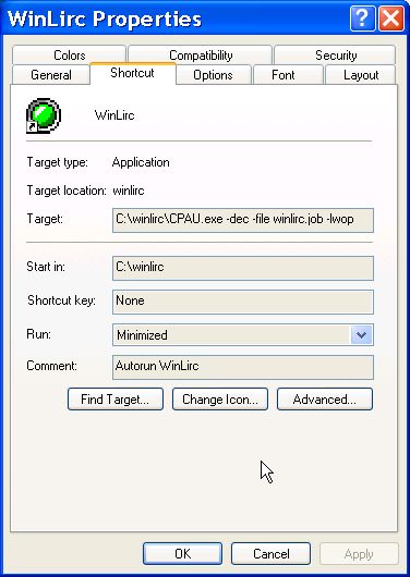

I recently installed WinLirc & EventGhost on a HTPC machine and here's a little how-to for running winlirc with realtime priority for anybody interested:
First of all, I had my windows set up so that the account used on the computer is only in "users" group, so he does not have administrative priviledges. That then leads to winlirc being run only at "High" priority, which is not enough, I wanted "Realtime" priority for the winlirc process.. To fix it you must run the winlirc process with more priviledges and this is the tricky part if you want to keep your system clean.
You could do one of these three things to make it work:
1. Start the winlirc process with different account than your own, namely the "Run As" feature of windows.
2. Start the winlirc process as a system service (using firedaemon for example).
3. Start using an account with more priviledges.
I went for option no.1 because it is the cleanest way to do it.
WinXP actually ships with a tool for doing exactly this (runas.exe), but that will present you with problems since you want to autorun winlirc without being prompted for a password. You definately don't want to use the /savecred feature of runas.exe since it's basically a gaping security hole.
I recommend using a freeware app called CPAU to archieve the same thing and more! First place the cpau.exe in the winlirc directory. ("C:\winlirc\" in my case) And here's how to use it:
So now you have created a .job file which is a crypted file containing instructions & all the credentials for cpau.exe to launch winlirc with elevated priviledges without asking for input. When used with cpau.exe this .job file can not be used to run anything except a winlirc.exe file that matches the crc checksum, so it can not be misused to run any other executable.
Keep in mind though that this winlirc.job file contains the password for the account you specified and in theory with enough determination and cracking know-how it is possible to decrypt the file and get the password. Therefore as a precaution I created a new local user "winlirc" which I gave local administrator rights. This way I'm not potentially compromising any of my even more important accounts or their passwords.
To run the winlirc.job file:
Then finally make a shortcut in "start menu\programs\startup\" to autorun it when you logon and you should be all set!

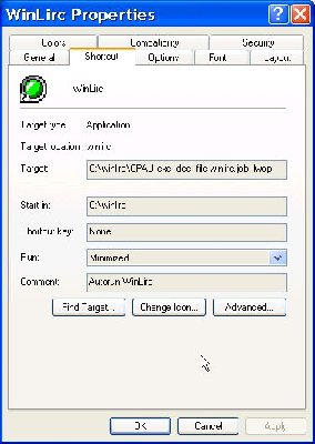

The command completed successfully.Keep in mind though that this winlirc.job file contains the password for the account you specified and in theory with enough determination and cracking know-how it is possible to decrypt the file and get the password. Therefore as a precaution I created a new local user "winlirc" which I gave local administrator rights. This way I'm not potentially compromising any of my even more important accounts or their passwords.
C:\winlirc>CPAU.exe -dec -file winlirc.job -lwop
CPAU V01.11.00cpp Joe Richards ([email protected]) November 2005
Current Security Context: MYDOMAIN\video
Attempting to use job file winlirc.job
Successfully Processed Job File
Verifying CRCs...
Process Created...
The command completed successfully.Then finally make a shortcut in "start menu\programs\startup\" to autorun it when you logon and you should be all set!
