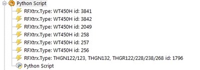

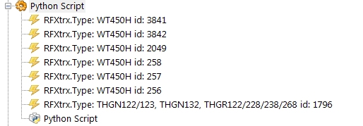

The plugin now shows correct wind direction and wind speed, e.g. 0 degrees for North, 90 for E, 180 for S and 270 for W. I enabled the logfile so I wouldn't have to copy down all the debug values, but I can't find the log file! Where is it and what is the file name?

For some reason, the rain sensor doesn't get picked up by RFXtrx, even with all protocols enabled. The station picks it up, so it works. I have asked Bert for advice.
