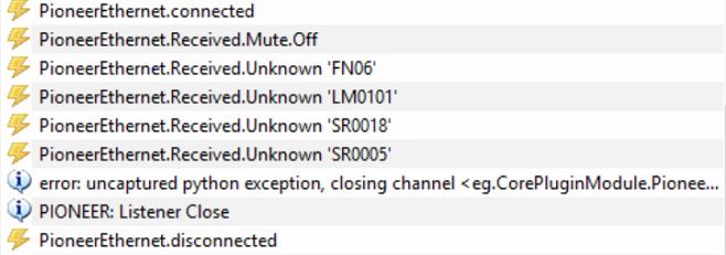

The plug-in is crashing after the receipt of most messages from the receiver. I'm getting:
error: uncaptured python exception, closing channel <eg.CorePluginModule.Pioneer AVR.PioneerEventer connected 10.10.2.73:8102 at 0x475c558> (<type 'exceptions.TypeError'>:Odd-length string [asyncore.pyc|read|76] [asyncore.pyc|handle_read_event|416] [asynchat.pyc|handle_read|158] [C:\Program Files (x86)\EventGhost\plugins\Pioneer AVR\__init__.py|found_terminator|239])
When starting up (re-enabling) the plug-in, I get all of the Pioneer.Received.Unknown 'XXXX' entries, then as soon as I do something, like press the AutoSurround button on the front panel, I get the error.
EG r1640
Win8 Pro x64
VSX-1123
Any thoughts?
Sem;colon
Posts: 625
Re: New Pioneer AVR Network Plugin
Post by Sem;colon »
Hi kkl,
it seems like you are using the other Pioneer Ethernet Plugin (yes, there are two for the same thing ;-) )
If you have trouble using the other plugin (what was the reason for me to create this second plugin) you could give mine a try (download at the first post) or go to the topic of the other plugin viewtopic.php?f=9&t=3488&p=27349&hilit=+pioneer#p27349
Mine is not as comfortable as the other one, but it runs very stable.
kkl
Posts: 317
Post by kkl »
Sem;colon wrote: it seems like you are using the other Pioneer Ethernet Plugin
Doh! :oops: Thank you for the quick reply, and for the plug-in!

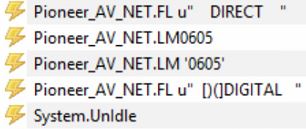

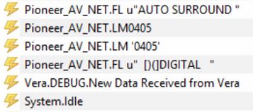

Sem;colon, now that I've got your attention, I hope you won't mind another question. The event Pioneer_AV_NET.FL u" [)(]DIGITAL " doesn't seem to be associated with a payload event. Dragging it to the configuration pane just gives Pioneer_AV_NET.FL. What I'm trying to do is every time the receiver is in Dolby Digital mode, change it to DD EX (0022SR). The 0022SR command works, but I don't have the DD trigger. Is this possible?
Sem;colon
Posts: 625
Post by Sem;colon »
kkl wrote:Sem;colon, now that I've got your attention, I hope you won't mind another question. The event Pioneer_AV_NET.FL u" [)(]DIGITAL " doesn't seem to be associated with a payload event. Dragging it to the configuration pane just gives Pioneer_AV_NET.FL. What I'm trying to do is every time the receiver is in Dolby Digital mode, change it to DD EX (0022SR). The 0022SR command works, but I don't have the DD trigger. Is this possible?
well, you never see the payload when you drag the event in your configuration; To trigger on a specific payload like " [)(]DIGITAL " you would have to write a little python script like this:
if eg.event.payload=="  [)(]DIGITAL   ":
    eg.plugins.Pioneer_AV_NET.SendCommand(u'0022SR')
But I would recommend to use the Pioneer_AV_NET.SR**** event(s) to trigger your macro.
kkl
Posts: 317
Post by kkl »
The problem seems to be that there are no SR**** or LM**** events that are specific for DD mode. If I use AutoSurround to get to DD, I see:
If I use Direct, I see:
So, there are numeric codes for the modes that get the receiver into DD mode, but not for Dolby Digital itself. This isn't the fault of the plug-in because Pioneer doesn't seem to provide a code for it, which is why it would be nice to be able to trigger on " [)(]DIGITAL ".
I will try your script example, if I can figure out when to test for that payload. Thanks again.
Sem;colon
Posts: 625
Post by Sem;colon »
I see...
well, the script should work for you ;)
kkl
Posts: 317
Post by kkl »
Sem;colon wrote:I see...
To close this out, yes, it worked great. Thank you very much. It just took me a long time to realize that even though the full payload wasn't displayed, it was still there.
