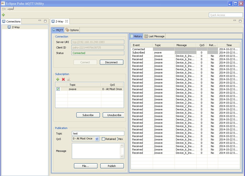

Re: RaZberry: a full featured Z-Wave Home Controller
Depending on the results from the test described in the previous post, it might be better to use a separate MQTT Client to verify that the Mosquitto broker is working correctly in your Pi.
Below is a screenshot where I use Paho for Windows. You find it here:
http://www.eclipse.org/paho/clients/tool/

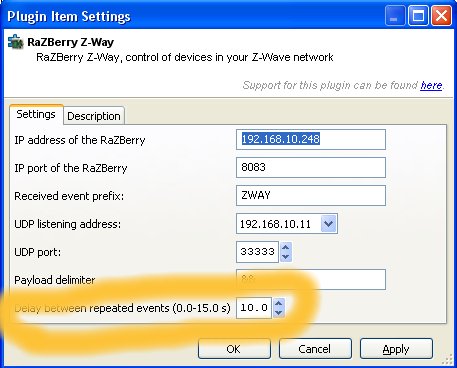

The motion sensor is working as well. You mention I can add a delay in the plug in, I can't see where though?

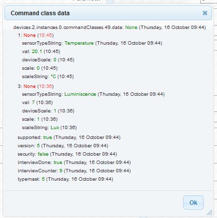

the fibaro also has a luminance detector as well, how do I add that?
This is where main.js is needed to modify. The basic functionality is that you have to 'bind' to events in the Z-Way. Like it is done for temperature and switches it needs to be done for luminiscence events so we need to add a section for this in your main.js (eventually we need to add a new function as well), all this is rather straight forward. A very optimistic guess is that the code to be added to the main.js could look like this:
function sensor_luminiscence (device, instance, theValue) {
    device += "";
    instance += "";
    theValue += "";
    eventString = 'Device_' + device + '_Instance_' + instance + '_luminiscence';
    publish_mqtt(eventString, theValue);
zway.devices[2].instances[0].commandClasses.SensorMultilevel.data[3].val.bind(function() {
    sensor_luminiscence (2, 0, this.value);
To verify, please post here the response you get from the browser when you are entering the following url's where 'pi' is the ip of your Pi:
http://pi:8083/ZWaveAPI/Run/devices[2].instances[0].commandClasses.SensorMultilevel.data[1].val
http://pi:8083/ZWaveAPI/Run/devices[2].instances[0].commandClasses.SensorMultilevel.data[2].val
http://pi:8083/ZWaveAPI/Run/devices[2].instances[0].commandClasses.SensorMultilevel.data[3].val

delay sorted (was looking in the wrong plugin :oops: )
data[1] is providing temperature
data[3] is providing luminescence
data[2] - Error 500: Internal Server Error
Uncaught TypeError: Cannot read property 'val' of undefined
(maybe its the battery level or the movement alarm sensor)
