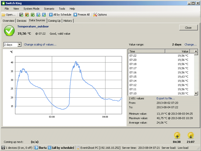

SK has a nice feature supporting data sources that can be set from external, in my case from EventGhost (EG). In the example below you see a graph showing my outdoor temperature for the last two days (the sensor is actually a OneWire sensor and is positioned in south/east, therefore the big variations).

- define data sources in SK to be used for your thermostats (one per thermostat)
- configure one or several macros with a python script(s) in your EG configuration that retrieves the temperature(s) from your Nest plugin and sets the data source(s) in SK
- as soon as the macro runs and fetches the data from the plugin, you should see this being updated in the graph in SK

- as I see it, it is not possible to combine multiple data sources into one single graph
In addition, SK can do so much more, it is worth checking this out. No license is needed for using only data sources
