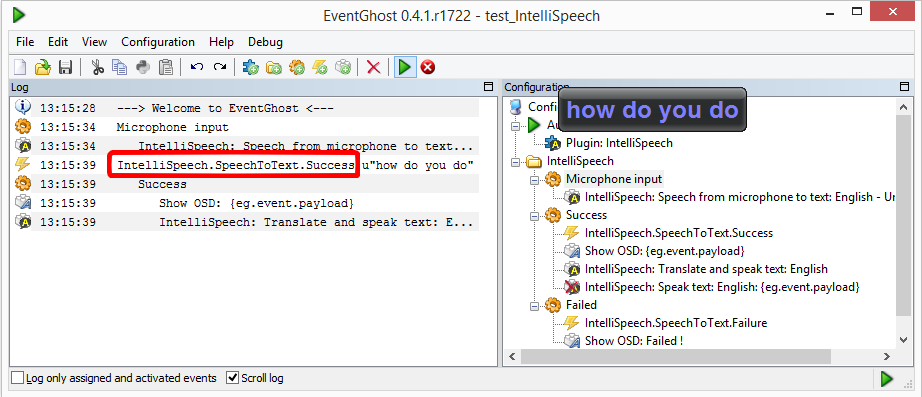

Re: IntelliSpeech
dorr35 wrote:I tried to speak while notepad was open but nothing happened.
I do not know what you expect. You do not need a notepad.
Try using the attached configuration file (it works as a translator from English into German).
Highlight the item "Microphone input" and press green button "Execute Item". Then speak.
Note: The result of processing input from the microphone is always an EVENT. In the picture is marked.
The text is a payload. It is necessary to somehow process.
test_IntelliSpeech.xml
(1.69 KiB) Downloaded 145 times
