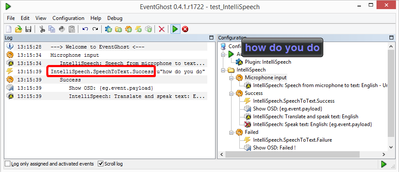

Try using the attached configuration file (it works as a translator from English into German).
Highlight the item "Microphone input" and press green button "Execute Item". Then speak.
Note: The result of processing input from the microphone is always an EVENT. In the picture is marked.
The text is a payload. It is necessary to somehow process.
