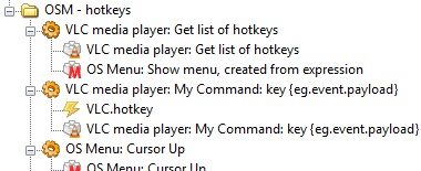

4) Action named "Get list of hotkeys". If bellow this action adding the action "OSM / Show menu, created from expression"
you get on screen menu with all 101 commands. For instance:
