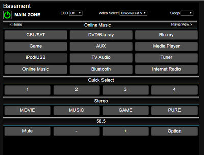

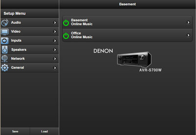

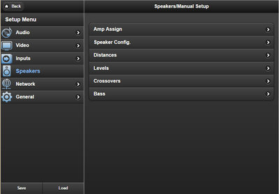

It's pretty much raw jquery styling, they threw some icons on top of it. Looks like most router settings pages. Here's a couple of screenshots of it.but I think you idea of doing the web UI would be an awesome addition as well... because I know the built in one is not up to snuff. (well so says the jibber jabber on the net)
