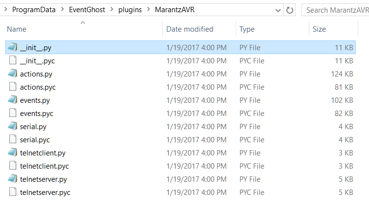

No log file in the ProgramData folder. Didn't change default of Debug = TRUE in the __init__.py file.
Still had issue with socket connection after disabling plug-in, closing EG, restarting, then enabling plug-in. Was able to connect after 3 disable/enable cycles:

in the appdata folder
not the programdata
c:\users\YOUR_WINDOWS_USER_NAME\appdata\roaming\eventghost
i did say appdata right??
well if i made a boo boo sorry about that my bad.. i meant to say appdata
send that file and it will reveal all to me... LOL
