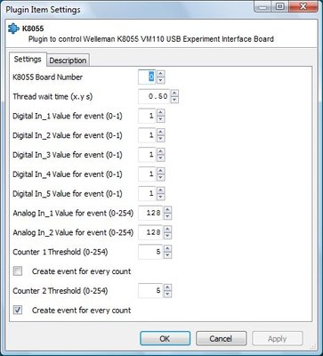

On request I have added a function that allows you to get an event on every counter count
The function is selectable per counter
New version is in the first post
When you start the first time with a configuration made with the previous version, you will get an error message. This is normal
To migrate from previous version, after the error message appears in the eg log, open the plugin setting and click ok
