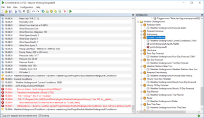

Good deal. Currently I'm able to pull in the current conditions if I pull in everything with the example you posted.
print str(eg.result)
The following is causing the window to bleed. :(
print eg.result.Apr08.High
print eg.result.Apr08.High.english
I've shared a screeny. Not sure what the problem could be.

ok Mr. John. LOL... i am going to poke ya with a stick a bit.,.
you are asking for a date with Night you would be looking for what??? a Forecast... but what action are you using?? Current Conditions. well sir.. if it's current then there is no date and no forecast for the evening either... you ahve to use one of the forecast actions if you want to look into the crystal ball and see the future.

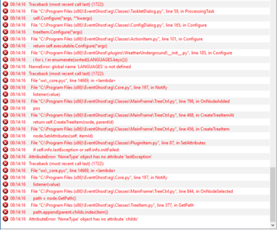

Unfortunately both version 0.5b and version 0.7b bleed in the log when they are installed. Here are screenies of what shows up in the log.
Error log for 0.5b
Error log for 0.5b
Error log for 0.7b
Error log for 0.7b
Re: Weather Underground Plugin
Posted: Sun Apr 09, 2017 2:16 pm
by kgschlosser
ok sorry about that i missed changing something out. But this should do the trick.
make sure you delete the old plugin first. as this one the file layout is completely different.
