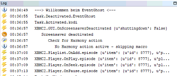

Re: New version 0.5.0-rc3 is out
Posted: Sat Jul 08, 2017 1:13 am
by kgschlosser

kgschlosser wrote:@Luca Brasi
I am wondering if you might have an orphaned port.
have you rebooted your computer at all?
This I did but...

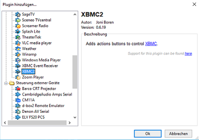

kgschlosser wrote:You are running a different version of the XBMC plugin. I would check the version of the plugin...
You got me there! Looks like RC3 is coming with a pretty old version of XBMC plugin
I installed the latest version which was running before with rc2 and everything is fine now
screen_mmnote_2017-07-08 08 37 58.png (41.94 KiB) Viewed 5096 times
Should have figured that out myself. Not the first time this has happened :-)
Thanks mate
