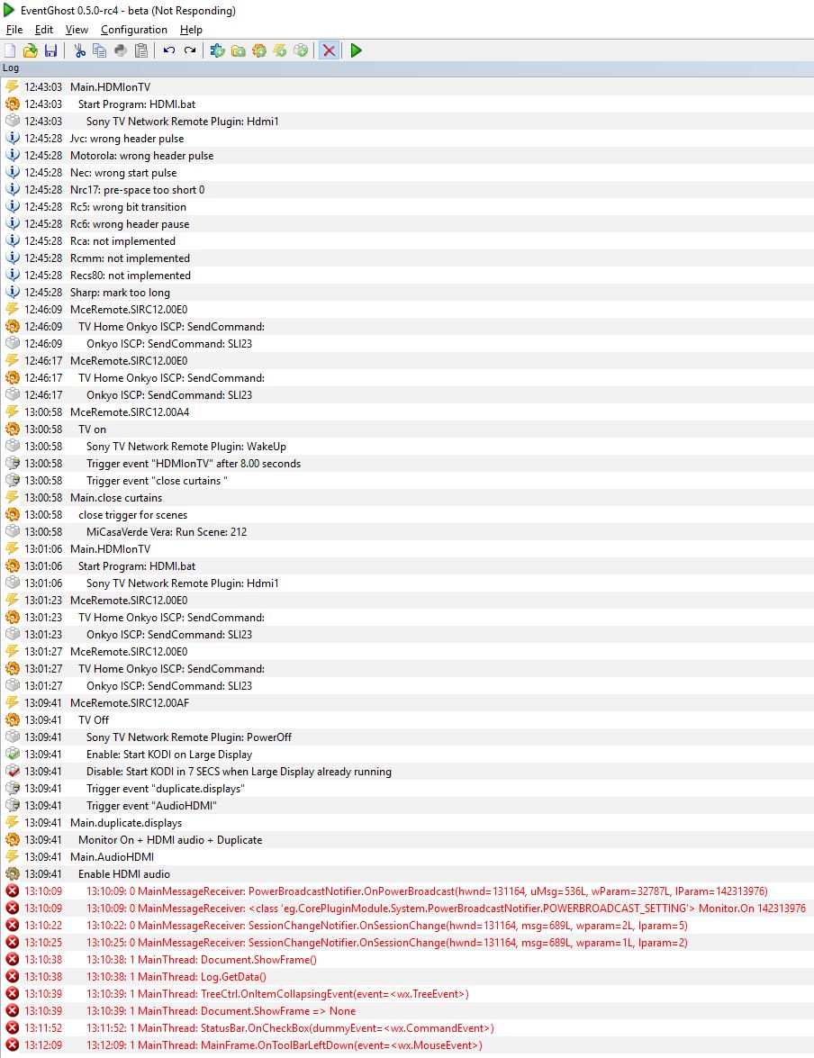

I use the webserver too, and got the same error, but even with debug on, nothing showed up in the logs. It showed up on the side of EG, but I couldn't capture it.

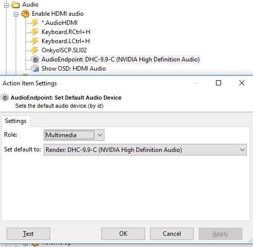

But I did just get a crash, and got both log, and screenshot. So it either crashed trying to set my audioendpoint to a device that didn't exist because I was in remote desktop, or the crash happened when I logged in 'locally' after remote desktoping.
This is the macro where the eg log stopped working.
eglog.zip
(11.21 KiB) Downloaded 103 times
