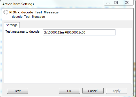

In the RFXtrx plugin, there is an action called 'decode_Test_Message'. What this thing does is that it injects a message into the plugin where it would appear when it comes from the HW device itself. In order to try if the plugin handles this correctly, we need to inject a message that says wind direction NW. If this is understod/decoded correctly by the plugin, I think the problem is 'outside' so to say.
This message (as it comes from the RFXtrx) is exactly such a message:
105602020d000145001d00156874205249My released plugins

Aha, I see, sorry, did not explain good enough
1) In the computer running the RFXtrx plugin, add the action 'decode_Test_Message' and the following typical view will be presented
2) What you see is the typical hex code message structure that we receive from the RFXtrx
3) Copy & paste the hex code example I posted above, click Apply and then Test. You will then see an event created, in this example as if it came from the wind sensor

Re: ClimateDataCalculation
Yep, I get northwest from that.
