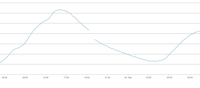

Weird, I still have those lines down to zero. Also it seems to be very sensitive to the gaps, probably too sensitive (a few minutes, and there's a gap). But worse: Opening the graph locks up Firefox for a minute or two. Any idea what that can be? I'm PM'ing you the address to one of my graphs.

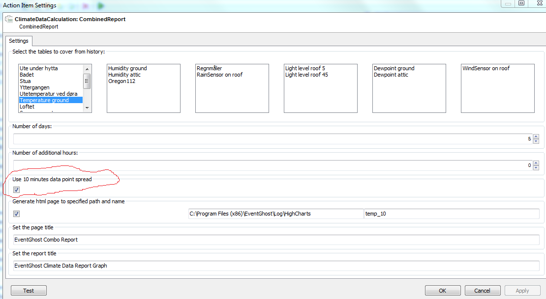

So here is a new version that supports making charts with 10 minutes data point interval (default). To update, replace with the new files, restart EG and open/save existing actions for Combo reports.
To select/deselect the new setting, tick the check box as below

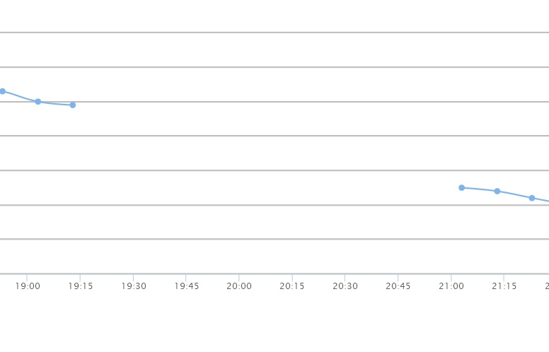

This looks like this in the graph, zoomed in:
So there's a gap between 18.19 and 19.09, but there is a lot of data, just not on the exact 10 minute. Is it possible in any way to read the closest data to the ten minutes instead of getting that gap, or is that impossible? I'm just asking, I have no idea about this.

Hmm, it looks like there should not be any gap here...
It works that way (or should). In the python code I am looking at the time when it is changing. Lets say it is now 18:19, I will then pick the first value found recorded at that time. The next will be the first value found at 18:20. And so on
Maybe you could PM me the link to download your db where this error is happening and I will have a look at it

Re: ClimateDataCalculation
In your db for 'Loftet', I can see the gap from '2015-05-29 21:52:21' until '2015-05-29 23:44:22'.
I realize however that I'm not handling gaps larger than one hour...so maybe this is messing up the graph (I'll have to fix this)

Nice, thanks for the script! :) As for the gap the missing bit is from 18:18 to 19:08 in the graph, and there seems to be data in the graph in the period where there actually are no data in the database. So you're probably right, as usual. :mrgreen:
I found the problem (handling more than 1 hour gaps). Updated the CreateComboHtml.py file
Now I think it looks correct

Are you certain? On my system the gap seems to be between 19.13 and 21.03 now, not 21.52 and 23.44 (when zooming in and holding the mouse over the data points).

OK, it seems to be something weirder. It saves a new report, but the data in the new report stops at 14.51 today.
I think I see your point, you are correct, something is wrong in the calculation & gap compensation I am trying to achieve. It is easy to see if you generate a chart for five days, then it should match ok but for 30 days it gets corrupted...
I need to see if I can improve the gap compensation
