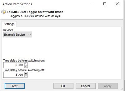

im using a tellstick duo and eventghost, i use the toggle on/off function on one of the switches, but it switches back so off to fast, is it possible to delay the on/off toggle for about 3 seconds?
so when i push on och the button, it will switch to off after 3 seconds, not emideately as it does now.
thank you
Re: TellStick Duo
The use case is relevant. I have added a new action (ToggleOnOffWithTimer) to keep the compatibilty with existing user configurations.
Updated version uploaded & available

Post by tjabas »
Thank you very much, really apreciate it.
But how do i install it?

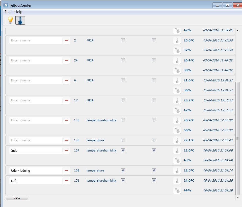

I just bought two Proove temperaturesensors that show up perfectly in Telldus live but they dont show up in eventghost.
Are they not supported by the plugin?
Best regards
A very happyuser of the Tellstick Duo Plugin :mrgreen:
Re: TellStick Duo
Might be they are not supported.
Telldus is unfortunately not keeping the development of Live and Telldus Center synchronized in respect to supported devices. The plugin for Eventghost (EG) is depending on drivers & library files installed when you install Telldus Center. Only thing you can do is to verify that you are running the latest version of Telldus Center (I have version 2.1.2 I believe is the latest).
Once you have Telldus Center installed, you can check if the sensors are recognized there by entering the following screen:
If the sensors are shown there, we have a chance to show them in EG as well, might also be I have missed something in the coding of the plugin
Henrik4223
Posts: 47
Joined: Fri Mar 04, 2016 10:18 am
Re: TellStick Duo
Post by Henrik4223 »
Dear Krambriw
I have version 2.1.2.
And the sensors are showing up in Telldus center - see the screenshot (sensor number 167/168 and 151).
Does this help? 8)
