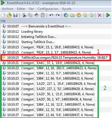

That is good news,
I have found that I do not support the message structure from your sensor. However, I think it is possible to fix. Please try the attached version and copy & paste here what is printed out in the log

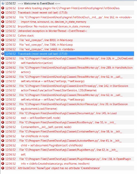

Re: TellStick Duo
SOMETHING WENT WRONG!!
Tried overwriting with the version from your website, but the problem persists?!?!?!
Re: TellStick Duo
Did you use a very old version?
Try this complete package that is from my system

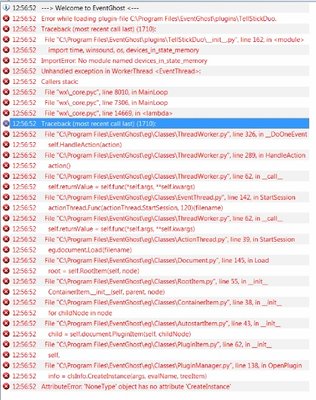

Re: TellStick Duo

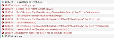

Hmmm - YES I must have used an older version. I have copied all your files in the TellstickDuo pluginfolder but am still experiencing errors:
Re: TellStick Duo
Well, in the very first post is a description I wrote how to upgrade from an earlier version. You did not follow that. Try to open the configuration and just save it once.

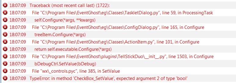

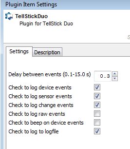

Re: TellStick Duo

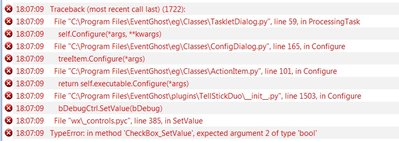

Dear Krambriw
Ihave tried it but I will not even open the configuration of the plugin:

Re: TellStick Duo
Comments to the abowe pictures should be switched with each other...
Re: TellStick Duo
Unfortunately it seems your plugin configuration for the Telldus Duo is so old, or has a very old format, that I am afraid you have to do like it is described here:
http://eventghost.net/forum/viewtopic.p ... 112#p39112
I personally would go for alternative 2)

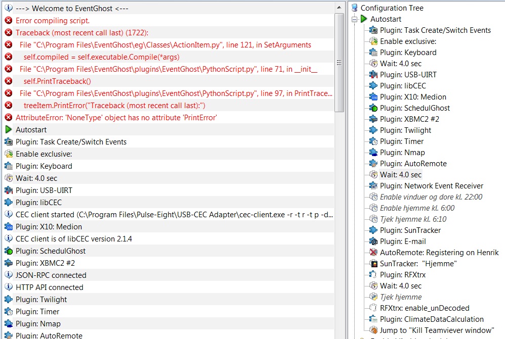

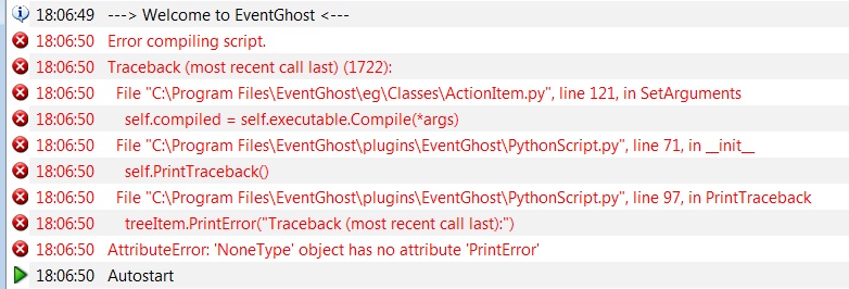

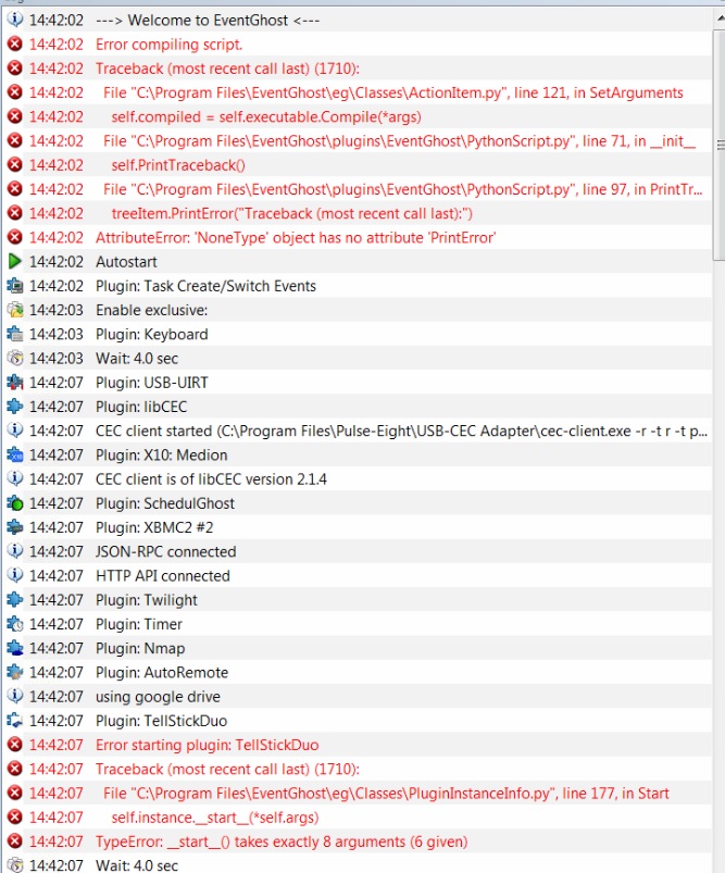

Re: TellStick Duo

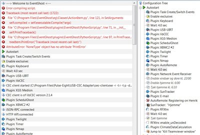

I really dont get it - I have now tried several things and amongst other things I have:
- Deleted all TellstickDuo actions (I only have about 10 - so not to bad
) AND the plugin (see below screendump)
- Reinstalled Eventghost
But I still get this error message
Re: TellStick Duo
As I see it, it looks as you have a problem in a python script. If you have python scripts in your configuration, you have to open and edit them to try to find the problem.

Re: TellStick Duo
EVERYTHING WORKS - thank you VERY much for all your help (it was a faulty python script that made the start error).
I now get the sensors up in telstick events

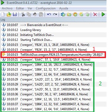

Re: TellStick Duo

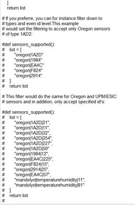

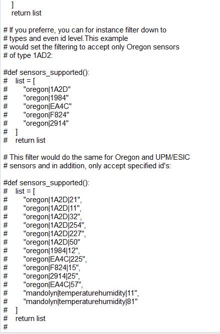

Hello
I need some help because my knowledge in python are null and not how to solve what happens, I commented my situation.
I have several sensors apaceren Oregon and I like the photo.
