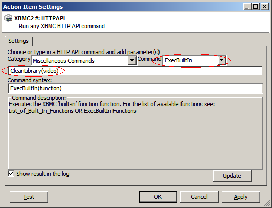

peppe_sr wrote:i would like to have a command to clean library from remote i found in the List of built-in functions this command: CleanLibrary(database). is there a way to set a command in the xbmc2 list to do this.
Sure :D . Unfortunately I haven't finished adding the built-in functions directly, but you can still use them via the Experimental\HTTPAPI action with command ExecBuiltIn using CleanLibrary(video) as parameter.
If you haven't used the HTTPAPI action before you need to press the Update button to download the syntax information, if that don't work you can still put in the command manually.
Hope this helps.
