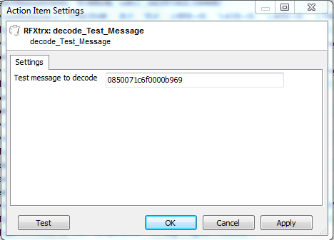

If I try your message it gets decoded correctly in my environment (in the plugin there is an action where you can test messages)
This action with your message
gets decoded to this
13:50:58   RFXtrx.Type: Viking 02811 id: 28416 ' temperature: +18.5 deg C signal: 6 battery: 9'

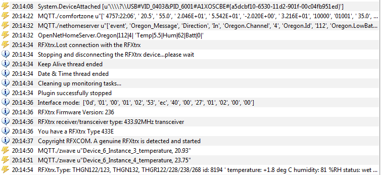

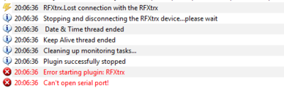

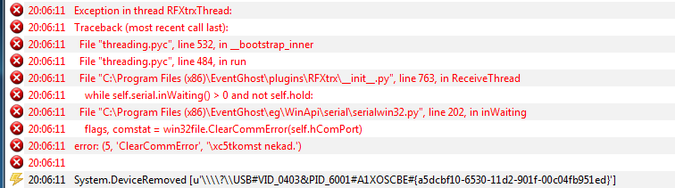

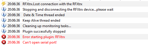

I have made a small correction, can you try the new current version?
Strangely enough, it is working fine for me. I test like this:
1) EG starts and plugin receives events, working normal
2) I disconnect the RFXtrx and receive this error message instantly
3) After a while (within a minute) I receive the following in the log
4) It gets repeated as long as the device is gone
5) I connect the RFXtrx and wait
....see next post (can only upload 3 pictures per posting)
Re: RFXtrx
6) Within a minute I see this in the log
7) Now RFXtrx works normal again, happy ending
