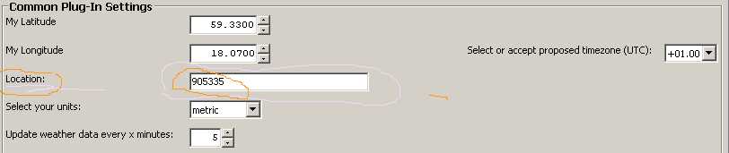

Dear Pako,
I think this feature has been included for a while. If you use the latest version (available in the first post in this thread) it is for sure there.
When you open up the configuration of the plugin you should find the settings like below in the picture (this is just example). If I try for Yahoo Weather for Prague, the location is 796597
https://weather.yahoo.com/czech-republi ... ue-796597/
The Coordinates of Prague in decimal degrees
Latitude: 50.0880400
Longitude: 14.4207600
(You can use this link http://www.satsig.net/maps/lat-long-finder.htm or your smart phone to get a more precise position of your home)
I hope this was what you are looking for,
My best regards, Walter
