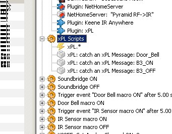

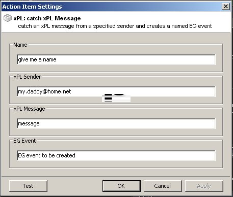

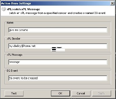

Hi damage,
I modified your plug-in a little bit. I added a new action that allows you to catch xPL messages from specifed sender and then create an EG event with desired name. It is based partly on the python script you once provided.
For me it works simpler to have possibilities to add actions for different xPL messages instead of creating/editing python scripts for each and every sender/event
Hope you can accept my proposal,
(11.98 KiB) Downloaded 305 times

Walter,
not quite sure i understand what you need to add this for. can't you drag xpl messages from the log window to the right side to make macros that trigger on those events?
Re: xPL plugin
Yes, basically you are right, this is what I could do and the end function would be the same
The action is just allowing me to organize the structure and configuration work a bit different
- assume I already have a lot of macros (with defined actions and events inside)
- I get a better overview of what xPL messages are affecting (collecting them in one specific place)
- I do not have to test the xPL messages during configuration
- mapping xPL messages to my internally already defined (and to me well known) event names
- most important, it handles xPL message sent from various devices/locations (xPL messages looks different when I send them from various devices like my mobile and from my computer at work)
But that's all, the other (default) way is of course also working
