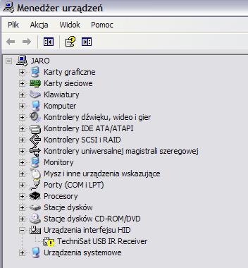

johndoe wrote:I have IR receiver similar to TechniSatUsb.
So I edit driver.inf to match my device (USB\VID_147A&PID_E019) and try to install.
After driver installed the device appears with exclamation mark on icon:
The attachment devicemanager.png is no longer available
"This device is not working properly because Windows cannot load the drivers required for this device. (Code 31)"
I've tried install on 2 different PCs, both failed :(
Hi
I've got the same problem with this drivers:
Error code 31
Win XP SP3
Please help :(
Greetings From Poland

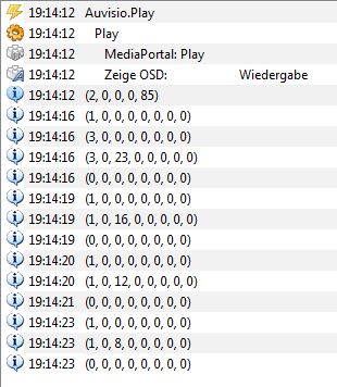

Hi there,
I discovered this great feature in the latest beta release. I installed it to get rid of some anoying hid problems but then on install eg recognized my remote and installed the driver and the plugin. So now everything is working nearly perfectly.
Only problem is that not all buttons create an action in eg. For example the color buttons. I tried to change the code but I have no experience in that. So didn't understand the code when i opened the ini.pyc.
I have a auvisio VRC-1100 remote. I added a screenshot of the incoming data in eg. The first one is recognized and triggers auvisio.play. The following 4 don't trigger any actions. Those are the color buttons.
Can someone please tell me what wo do?
Thanks in advance!
Luca

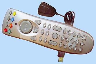

I've bought this remote http://www.dealextreme.com/details.dx/sku.14380
It seems similar to what Pako mentioned in this thread before, but it has different ID: USB\VID_073A&PID_2230.
So I added it to the USB driver inf file, it is in attached zip. Works well under Win7 64bit!
I've also did some little tweaks to Pako's plugin:
- GUID change
- changed code for Full screen button - maybe apply to other remotes?
Result is in attached zip.
Mouse keypad does not work well. It seems it somehow change also first byte of code for other buttons and then they don't work. I haven't spent much time with this. Maybe someone else could help?
Cichmen
DX_USB_Remote_2.zip
(20.85 KiB) Downloaded 380 times

Same remote I have.. ok I will grab it... the only thing needed in mine was fullscreen.. the mouse works good with the above modifications.. so if fullscreen is working I just need to add it to my modified one. Ok Fullscreen is now working! Yeah now all the buttons work now as well as the 4 mouse directions! Grab the modified plugin I attached to this post. The only thing that nobody has solved now so far is the 4 diagonal directions for the mouse pad.
DX_USB_Remote_modified.zip
(19.53 KiB) Downloaded 394 times
