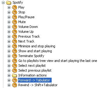

I didn't find any way to switch between the playlist and songlist, if I start to play a playlist and I want to hear the 10th song in that playlist I press "forward" on my remote controller (I have copied the macro Forward -> Tabulator) and the "marker" move to the songlist.
So when I press forward on my remote it uses the macro Forward - Tabulator and if I press rewind it uses the macro Rewind- Alt+Tabulator. That way I can switch between playist, songlist and the search field. I was thinking of maybe make a macro that enables the onscreen keyboard so that I can search for songs using the remote.

The new version now also has actions for tabulators (forward/back)
