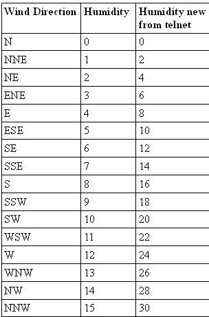

When i wrote down the humidity values for N E S W and so on i only looked in EG where as i understand now those values was divided by 2. This should still be done for the wind direction as N:0 E:8 S:16 W:24 acording to the telnet vs "the station". When you removed the divide by 2 for the direction it goes wrong.
The odd numbers like 1 3 5 7 9 and so on never apears in the telnet session. So i do not see any reson there should be numbers from 0-30 and having do place dummy directions betwen NNE and NE as it will never be sendt or recieved. The easyest way is to divide by 2.
So i changed the line 230 from:
self.wDirection[int(UPMsplit[6])]
to:
self.wDirection[int(UPMsplit[6])/2]
Smal change made to line 230.
(34.68 KiB) Downloaded 326 times
Now both the wind direction and the wind speed works as it should and display the same value on the "station" as in EG.

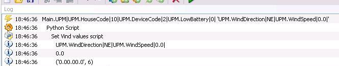

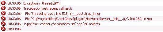

But i now have a fault when trying to use the rain bucket. When the event comes trough telnet i get a fault in EG and the reciever stops working. Have to restart EG to get it working again.

Also i tried to take the wind speed from km/h to m/s and knots. So that i can display theme all on web page.
Trying a smal script
p = eg.event.payload
p = p.split('|')
a = p[3]
print a
b = a * 3,6
print b
but my script only prints the value 3 times and ad ,6. Is this maby becouse there is a "." instead of a ","?
Best Regards, Jostein
Of course, stupid me :oops:
Change line 280 and try this instead
                                        str(int(UPMsplit[6]))+"|"+
Regarding your script, I would do like this (using type casting to be sure that variables are defined ok, maybe not needed) and you must change from , to . (it will not work otherwise)
p = p.split('|')
a = p[3]
print a
b = float(a) * 3.6
print b
Jostein

krambriw wrote:Change line 280 and try this instead
That worked. Thanks.

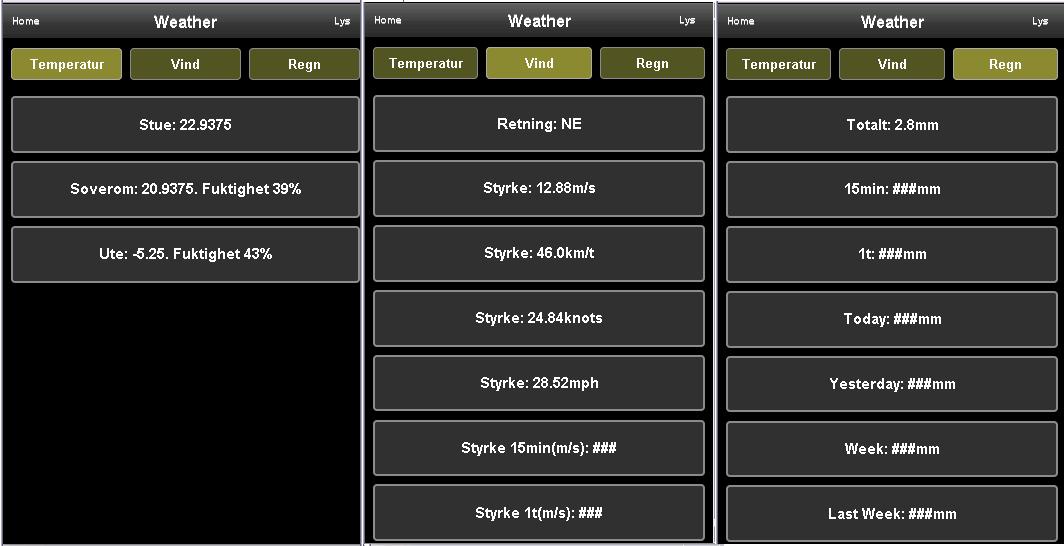

Now starting to take shape in my webpage(for iphone) riped from paseant`s. Not mutch left now.
Best regards, Jostein
That is so very nice made, really good looking!

krambriw wrote:That is so very nice made, really good looking!
Thanks, but the credits goes to paseant and you i have just riped his webinterface and put your values in there.
Still have to find a way to avrage the wind speed and also log and display the rain values.
Do you use a web interface for the tempratures? Do you have a way to display trends?
Best regards, Jostein.

What i would like is the sum of the rain for the last hour and day. The same way the station does. That way you can se if it has rained at all today and if it is raining now.
The values i want to display for the rain is:
  • Total(Working OK)
  • Hour(Last 60 min)
  • Previous hour(from 60min to 120min)
  • Day
  • Previous day
  • Week
The values i want to display for wind is:
  • Direction (Working OK)
  • Last direction before curent one (Think i can find a way to do that one myselfe using a phyton script. Not that important.)
  • Strenght now m/s, km/h, knots and mph (Working OK)
  • 15min or hour avrage(maby both)
mickelin what are your toughts here?
krambriw wrote:If history is most interesting to produce graphs, I think the log file should be used instead
Now i have no need for graphs was just vondering what u used yor values from the plugin for and what you plans are. Where does this logfile end up i have tryed looking in the plugin folder but cant find any log files.
Best regards Jostein
