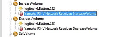

Hi.
Big thanks for this plugin!
The plugin itself seems to work just fine, but I was wondering if anyone have any advice as to how I can map System.Volume events to the Increase Volume action.
Re: Yamaha RX-Vxxx (or similar) Ethernet Plugin!
Posted: Mon Nov 04, 2013 6:53 pm
by Spragleknas
EDIT: Duplicate. Sorry!
Posted: Tue Nov 05, 2013 2:00 pm
by Dragon470
I am unclear what you are really wanting. Are you wanting when you hit the volume up button on a keyboard, only increase the amp volume? This is not really that hard, you will need the hid plugin for your keyboard. I use this setup, as I don't want the volume coming out of my pc to change, only the amp changes. Otherwise using the event System.Volume '75.00' and you use that to match the precent on the amp, you will be crating an exponential increase or decreasing effect. This also would requie a python script to use the exact volume.
With the keyboard button the events go just before the increase or decrease volume actions.
