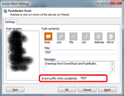

New version (0.0.12) released.
News:
  • added option to delete pushes, sent using this plugin
A more detailed description:
Action Push was expanded to include a new parameter - Event suffix:
Note: If the field is left blank, the event will not be triggered.
If you are sending a Push to only one target, then it's simple to use:
If selected several targets simultaneously, it will require some scripting.
Here's example how the payload of event looks, when you select two targets:
{'device_iden': u'0123abcd', 'type': 'device', 'nickname': u'EG_notebook', 'ok': True, 'push_iden': u'ujBlbIJ7TNcpjAtdrosor6'},
{'type': 'friend', 'ok': True, 'nickname': u'James', 'email': u'[email protected]', 'push_iden': u'ujyuu38KSs0pjz0Z1Zjaea'}
If "ok" = False, it means that sending failed and parameter "push_iden" will be missed.
