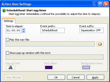

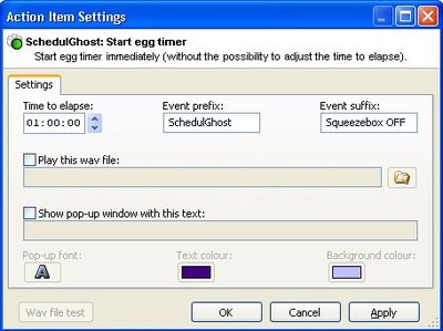

Re: Timer
Perry,
I have not seen the problem myself (currently I'm not using the timer plugin) but you should instead consider to use Pako's SchedulGhost.
1) Add the plugin
2) Accept or reject to add the proposed configuration tree (you could reject)
3) Create one simple egg clock action as the sample below You can then trigger the action from 'whatever'
Also from a script, you could trigger it very simple using this code as example
(Use 'Copy As Python' to copy your action, then paste in a script to get your correct syntax)
When you trigger the action, similar to this will happen (in this case I changed the egg clock to a 5 second variant):
You can then use the event 'Squeezebox OFF' to actually turn off your squeezebox(es)

eg.plugins.SchedulGhost.StartEggTimer((u'01:00:00', u'SchedulGhost', u'Squeezebox OFF', u'', u'', (191, 191, 255), (64, 0, 128), u'0;-56;0;0;0;400;0;0;0;0;0;0;0;0;MS Shell Dlg 2', (10, 10)))When you trigger the action, similar to this will happen (in this case I changed the egg clock to a 5 second variant):
07:32:28 SchedulGhost: Start egg timer: SchedulGhost.Squeezebox OFF:
07:32:33 SchedulGhost.Squeezebox OFF
