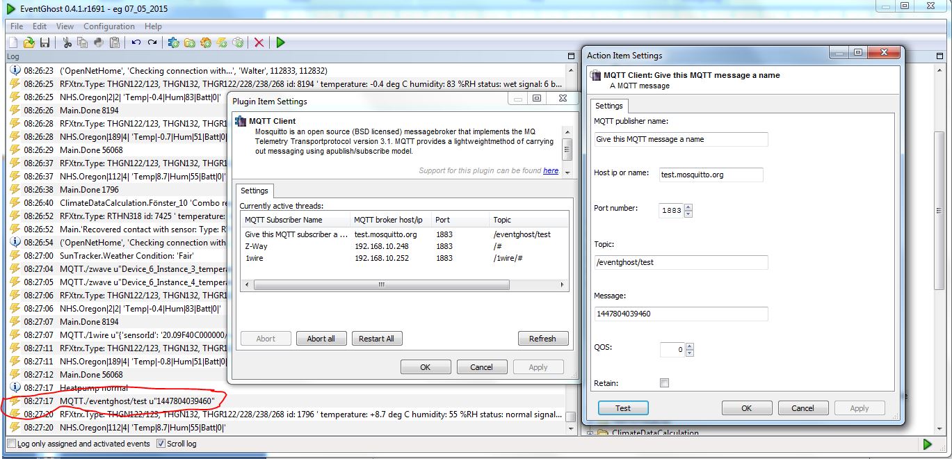

Good idea on the screenshot. This is EG's log of me testing it with the debugging print statements you asked me to insert into the code. Also, I have included the plugin settings window to see how I have it configured.
It appears I am not getting an event in EG. Does everything look okay so far?
Re: MQTT Client
It looks ok I think, you should receive events.
I have configured it similar and here it works when I publish a timestamp like that to a broker
PS just an idea! If you could change your setting to publish on the same broker & topic, I would expect that I would receive your time stamps and then I could see further what kind of problem there could be!
