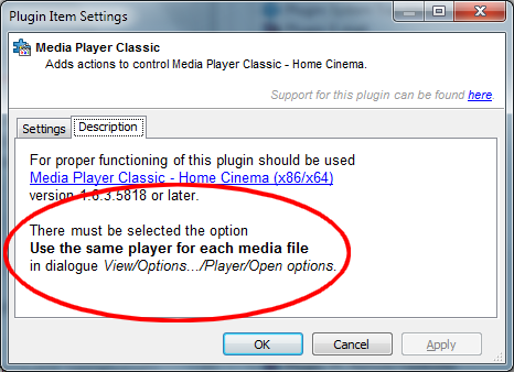

Re: Media Player Classic
Posted: Sat Feb 09, 2013 6:55 am
by Pako
That's interesting. I tried, as you describe it, but nothing bad happened.
But then I tried the same way to open a file located on a network drive. And voila - now the problem appeared!
I found that the problem lies in the fact that EventGhost is trying to connect with MPC-HC when MPC-HC is in a "Not responding".
So I had to add a loop in which the above condition is tested. EventGhost will try to connection only at the point when MPC-HC is responsible.
You can download the corrected plugin from the SVN repository.
It is possible that the some problem will reappear, but it should be much better. During my testing, everything was fine.

Ah, now I understand.
You did not set the path to MPC-HC in the main configuration dialog plugin.
Under normal circumstances (x86) it does not matter because the plugin can find the path myself in the registry. But you probably have a x64!
I have to make such adjustments to make it work in both versions. Meanwhile please set the appropriate path manually.
Problem with MediaMonkey possibly related to x64 too. However, I tried it and no problem occurred.

I stumbled upon a problem just after upgrading from EventGhost_0.4.1.r1572. The problem started appearing in r1580.
If i activate the Media Player Classic Plugin and i open a video file with MPC, an additional empty MPC window is opened.
+1:
I have the same problem with MPC-HC.1.6.5.6366.x86 and EventGhost_0.4.1.r1610 and mpchc plugin 2.5.
EDIT:
I found the problem:
As mentionned in plugin settings:
I checked my mpchc settings and it wasn't the good setting,..., this is the good one:
But i always have the ID keys problem.
Some of them are: "Menu DVD", "Up,down,left,right DVD" ..etc..
My test were wrong because i had the window problem.
Now it seems to work fine too :)

Pako wrote:That's interesting. I tried, as you describe it, but nothing bad happened.
The revision 1616 doesn't fix the problem, it just delayed the opening of the second MPC window.
But i use the option in MPC that says "Open a new player for each media file played".
I suppose i have to stick to plugin revision 1560 if the new plugin can't support this option in MPC.
liggers
Posted: Mon Feb 11, 2013 7:14 am
by Pako
liggers wrote:The revision 1616 doesn't fix the problem, it just delayed the opening of the second MPC window.
Yes, in this case, you have bad luck and you have to use plugins version 1.x.
The last version was 1.7, which was included in EventGhost r1572. For plugins version 2.0 and later, this rule applies:
The way back is not possible. Version 2.x have much more options. Some functions (which are now included in the plugin) would not have been possible before.
