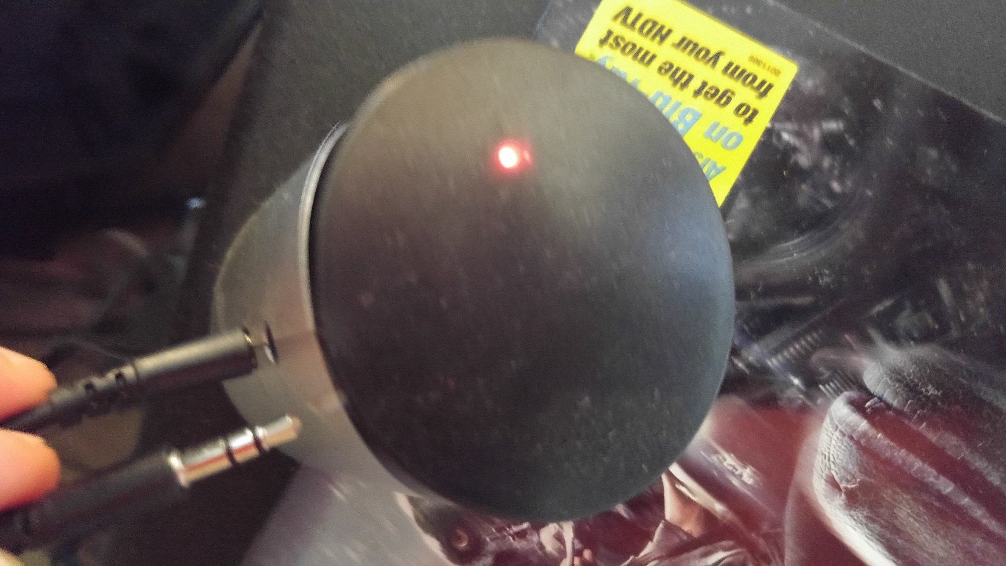

Here is a picture of my IR Transceiver. I have both cables plugged into the back of it.

I need to see the actual blaster the wire that goes to the ir sensor on your tv or avr

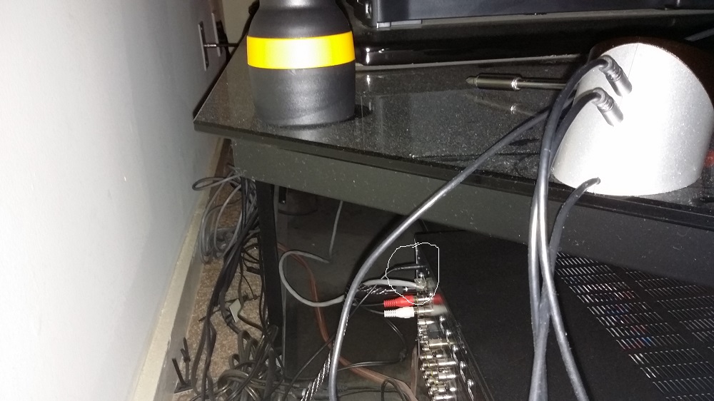

Those wires go straight from that transceiver to the TV, and Stereo Respectively. The Transceiver itself plugs into the PC VIA USB. I can take pictures of the back panels of the TV, and Stereo if that is what your looking for
Re: OS permission denied error
I am trying to get an understanding of what that device is plugged into???
it sounds as tho it's not a blaster if it's plugged into the back of the TV
if it was a blaster it would have one of those ir transmitters like i showed you in the picture.
so if you could take a picture of how the thing is attached to your TV it might help clarify exactly what that thing is.

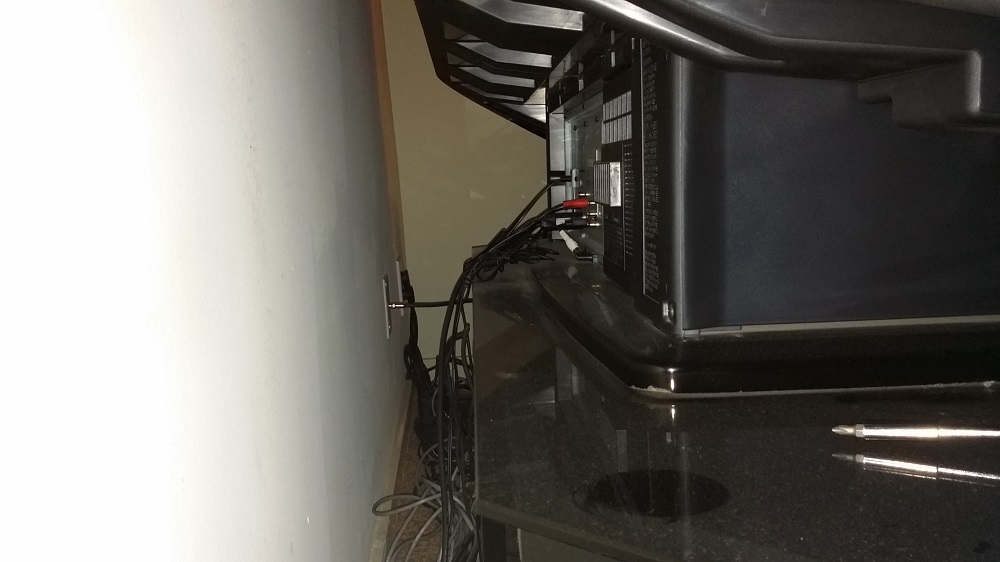

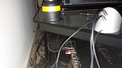

That is exactly what is going on, both cables are plugged directly into the back of the IR receiver. Ive attached two pictures. One of them shows the back of the stereo panel with a circle around the cable coming from the IR transceiver. The circled cable goes directly from the stereo to the IR transceiver. The other is a picture of the back of the TV. It is hard to spot exactly which cable is which but I posted that picture anyway to give you the idea that the IR transceiver is connected to the TV in the same manner as the stereo
and did you say it works this way with something else controlling the transceiver????
because it shouldn't i mean, i don't know much about that dell thingie but that setup is incorrect, that dell part is supposed to come with an irblaster as i showed you in the picture, and that blaster then sticks to the front of the device where the ir eye is (the ir receiver for the device usually is a small circle on the front)
what you are plugged into are serial data ports that are intended for control from same mfg devices
example: yamaha AVR and yamaha cd player, but you want one remote then you would connect the 2 via that connection
that port is not for ir pulses there is a series of commands and responses that travel down it.
that would be a good reason as to why it's not working :-D
now because you see the light blinking on the dell piece it means that the dell part is receiving the command even tho you are getting that traceback error, so what we need to do is come up with a means to catch that error so it won't show in the log file.
but that being said we still don't know if it is even blasting properly and we won't know that until you get the proper blaster cable for the unit
