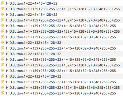

Well, it was working until I rebooted my PC...
-EG started up with windows but it didn't load my saved work, it loaded a default profile.
-Once I loaded my saved profile, the RED button didn't work. Seems all of the saved HID input strings are worthless because pressing the RED mce button now shows completely different HID strings. So I have to go through the same process of pressing the button a hundred times and adding the strings back into the macro.

Re: Help with getting MCE working and Add keyboard shortcut
I may have found a way around the long string problem. Go to the shortest string, look at the first number after the "1". That number will be found in every string. Rename/Create a string with that number and some asterisks, then delete/disable all other entries. In this screenshot for example use HID.Button.*22* and delete/disable all the other entries:

Hi tzr916tzr916 wrote: Wed Aug 30, 2017 4:24 pm I may have found a way around the long string problem. Go to the shortest string, look at the first number after the "1". That number will be found in every string. Rename/Create a string with that number and some asterisks, then delete/disable all other entries. In this screenshot for example use HID.Button.*22* and delete/disable all the other entries:
Thanks for your "asterisk hint" - I have the same issue as you have (had?) but the HID.Button.*xx* way doesn't work here: it's not recognized by EG.
